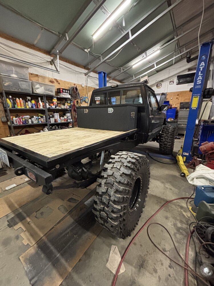

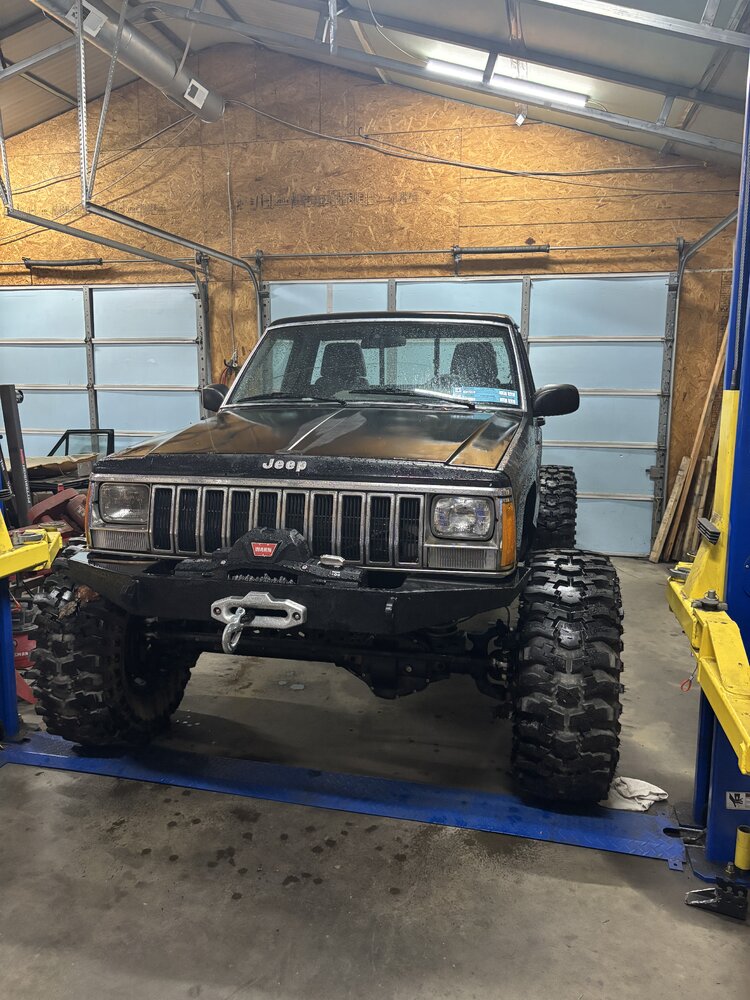

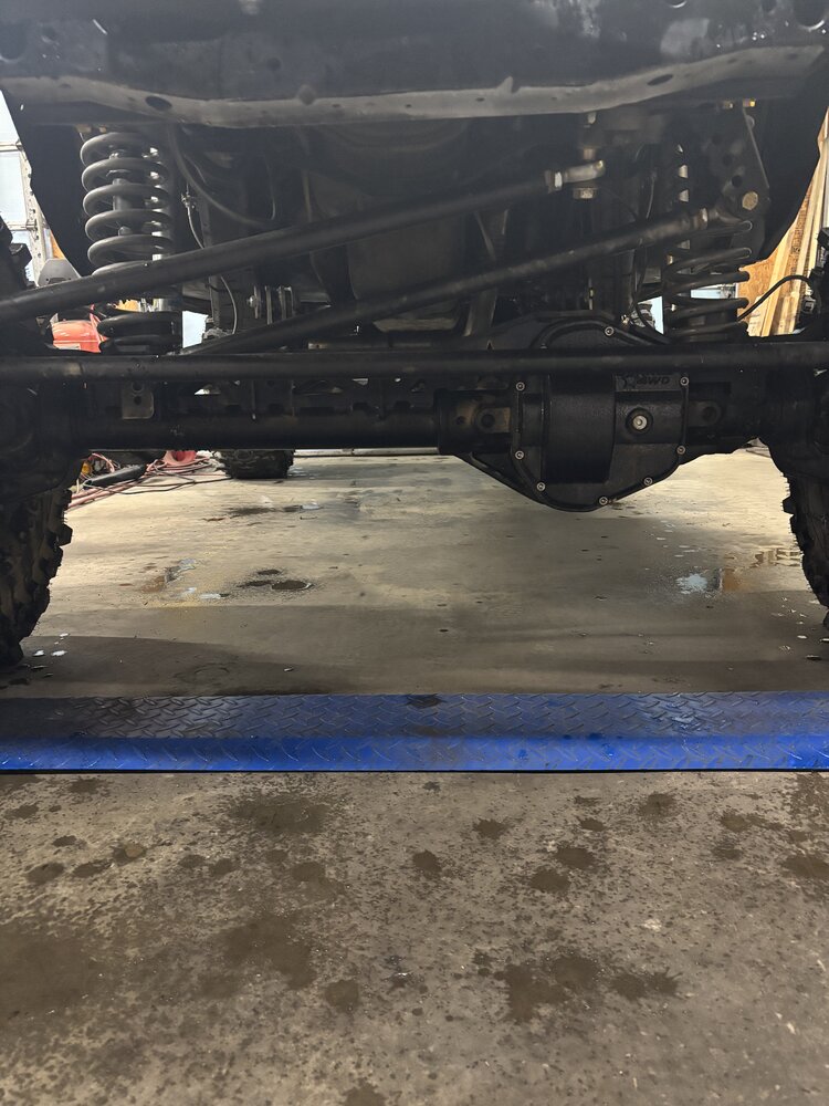

Jump forward 2 decades and I have install SD one tons with ARBs and 538 gears and a flat bed.

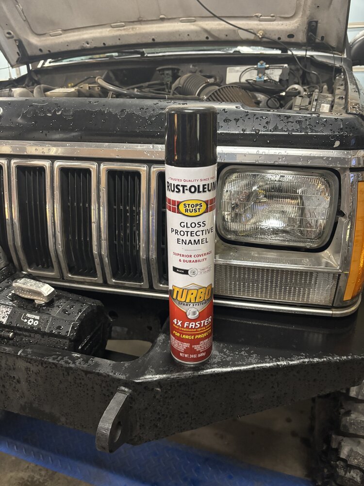

Plan for this week is to put some heat shielding around fuel lines, hood spacer, install switch and relay for the electric fan and test CPS due to cutting off when hot. Also going to turbo can rust-oleum paint it. We are taking it to the MB Jeep Jam for my wife's birthday and she is ashamed to ride in it with the green doors :laughing:

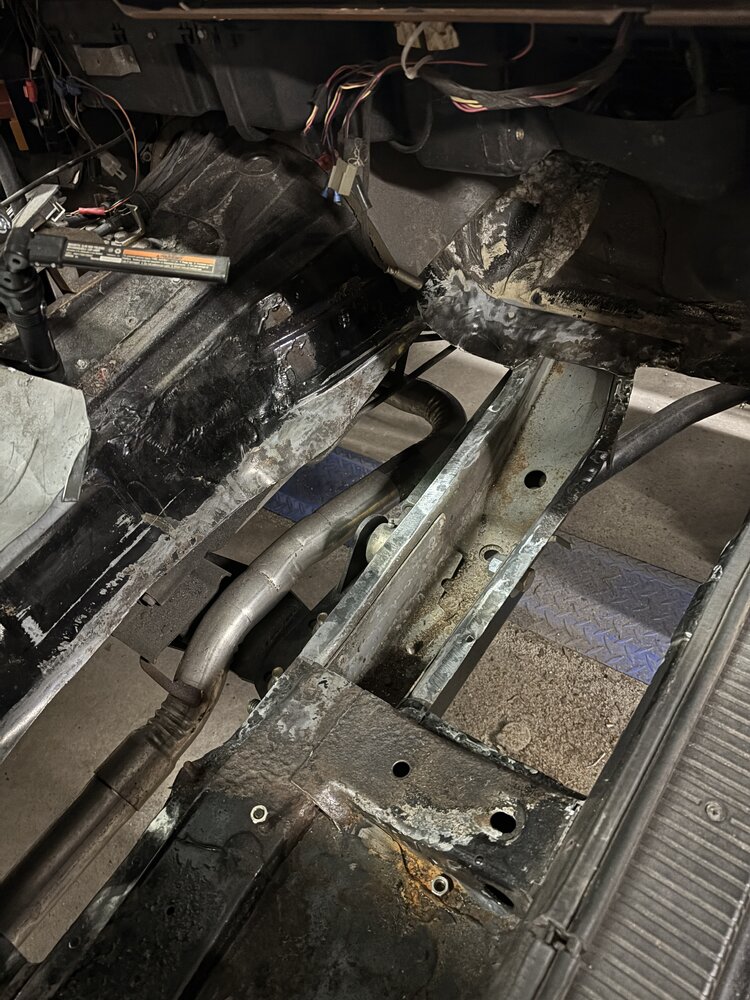

Here is what those vent windows did to my floor after seating 10 years in my yard,

Looks like you got the track bar and drag link angle dialed in pretty good after the turning radius issues.
A MJ on tons just looks badass! A few weeks back I was driving here local and passed a bright yellow one on what looked like SD axles and 40”+ tires being towed on a trailer. I don’t know if it belonged to someone local or if they had just gotten off I-26 to get fuel. It was super clean and looked like a new build. I haven’t seen it again since then.
Yes I got it close as I could without redoing everything. Thanks for your input on that, you helped a lot.
The exhaust cooks the paint there, if you can get a piece of shielding there it’ll go a long way
IIRC the exhaust is behind the cross member and there is nothing but a pipe there. Its after that the exhaust cooks the rear floor in an xj. the muffler and cat are there. I've seen a lot of driver floors eaten out from the master leaking too.
The hole he has is directly over the exhaust pipe, the spot you refer to is also a trouble area but has a factory heat shield, this area did not. Mine had the same problem when I had one
