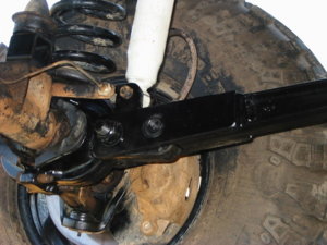

One cheap trick is to wrist the pass side radius arm. It releives the bind in the front suspension. Unpin for the trail and pin for the street. Or you could extend the front radius arms for a similar gain in flex.

I'm not sure about the full size, but the Rough Country, Skyjacker, and similar coils are pretty stiff in an Early Bronco. They may not be so bad with the extra weight of the full size. You might want to look into a set of progressive coils to go with a radius arm modification.
