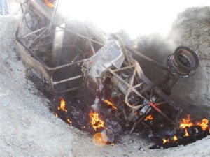

Leaking trans dipstick caused this.

I've seen on 2 occasions what a transmission fire can do to a truck, and once it's going, it's very hard to put out, you probably won't have enough fire extinguishers in your whole convoy of rigs to get it under control.
