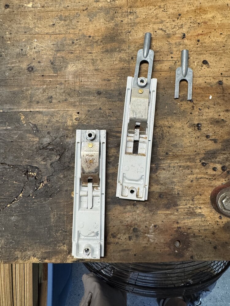

Not sure how to fix this issue without identifying the brand. Unless I custom fab some parts.

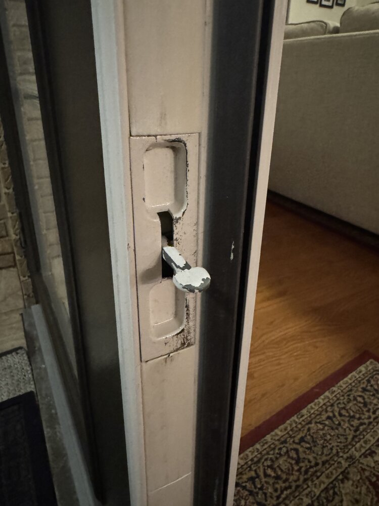

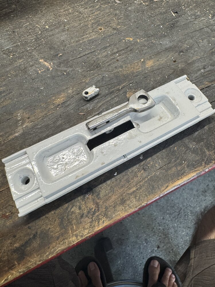

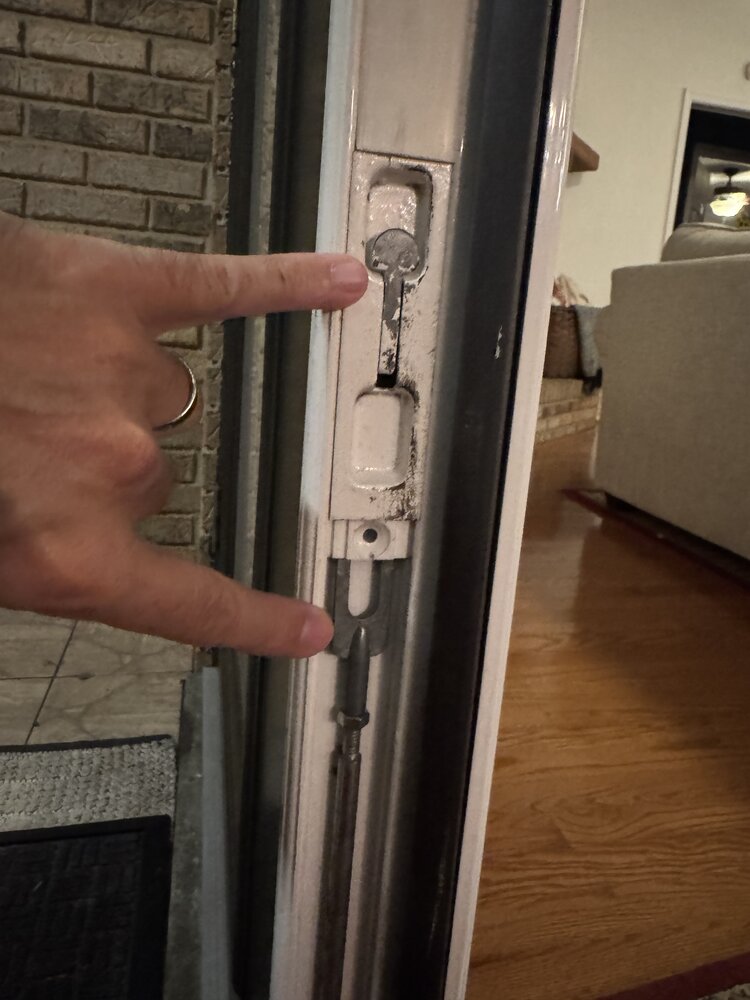

PO installed some French doors. The static door has header and footer locking bolts. One time while closing the door, the flip lever/switch thing was stowed away and the closing door broke the lever/switch thing-a-ma-bob.

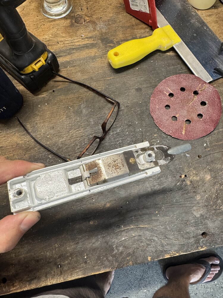

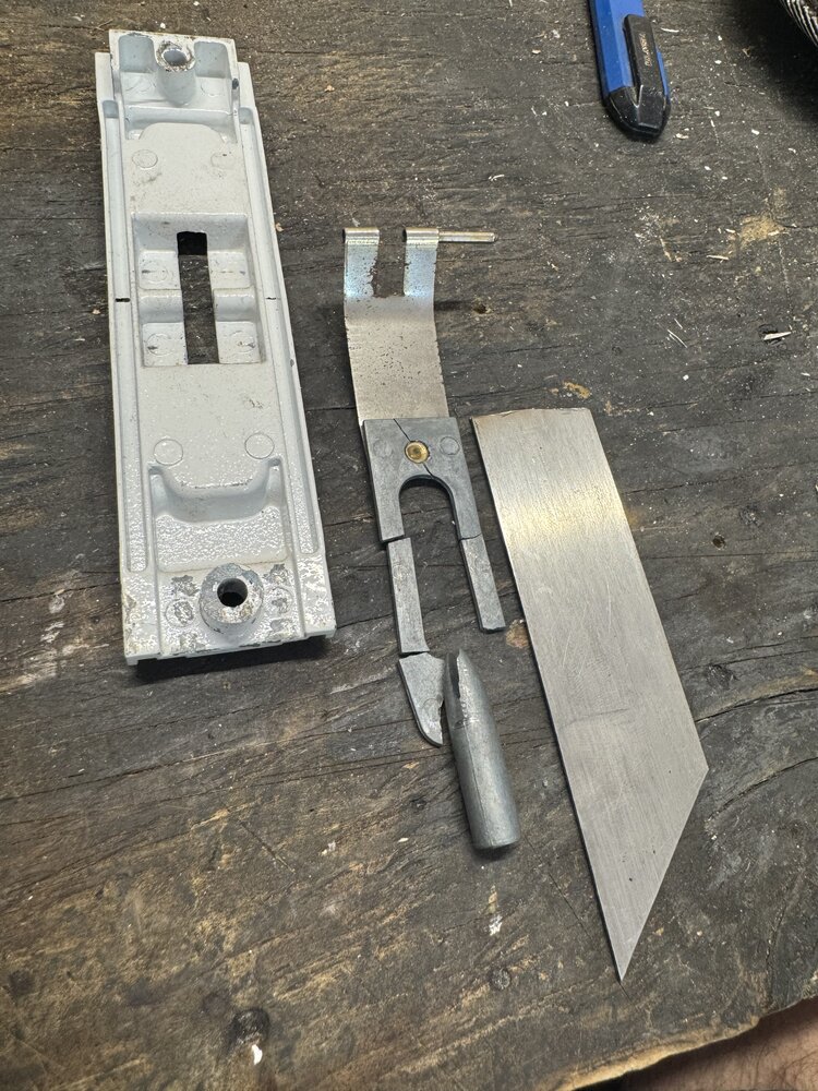

Separately, part of the internals that connect the lever to the bolt broke. It’s a POS cast aluminum part that accepts a threaded rod (the bolt) to the lever.

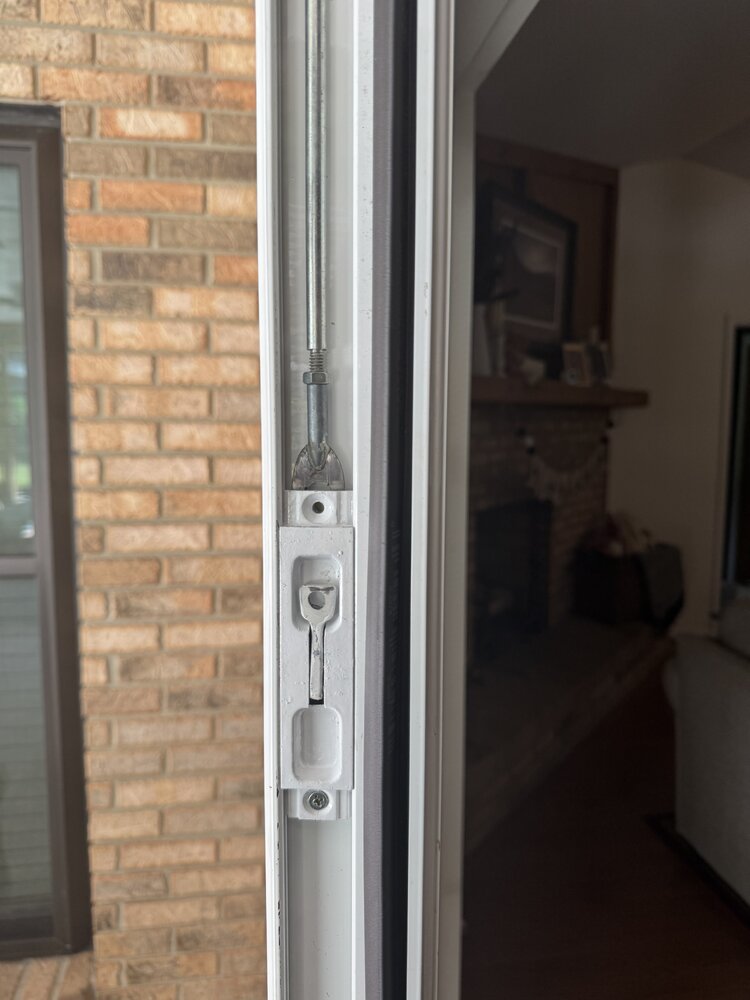

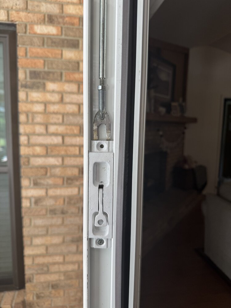

So I need these two parts. Pictures attached of the good parts from the opposite end.
I can’t find any identifying marks, numbers, branding… nothing! So I can’t look up replacement parts. My only thought is if anyone here can recognize the brand, or give thoughts on options to fix.

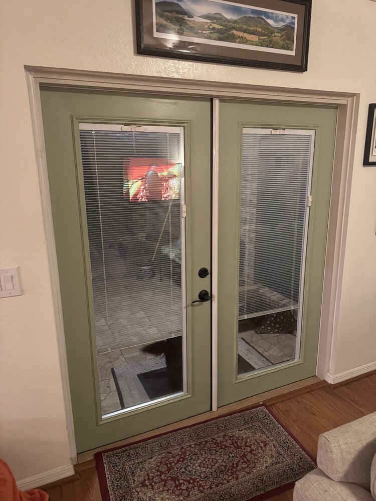

They look a lot like the Jen-Weld Doors up at Lowe’s, but there’s probably 8-10 years difference in models, I guess.
How long are the rods? Looks like you can get flush, 12", 18", and 24". I wonder how close a replacement assembly would be (size of the lever plate)?
How much modification to the door would these take to fit??

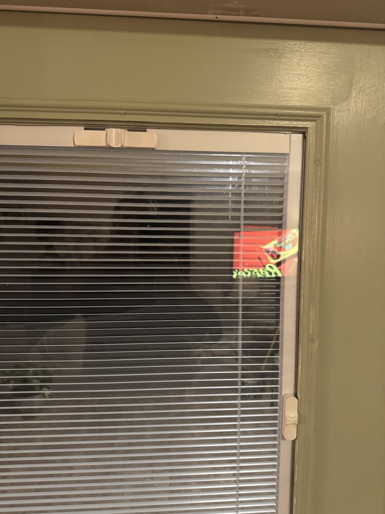

Pretty sure that is a jeld wen door had same door different issue. And th blind mechanism is a give away

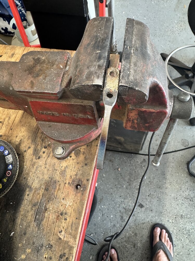

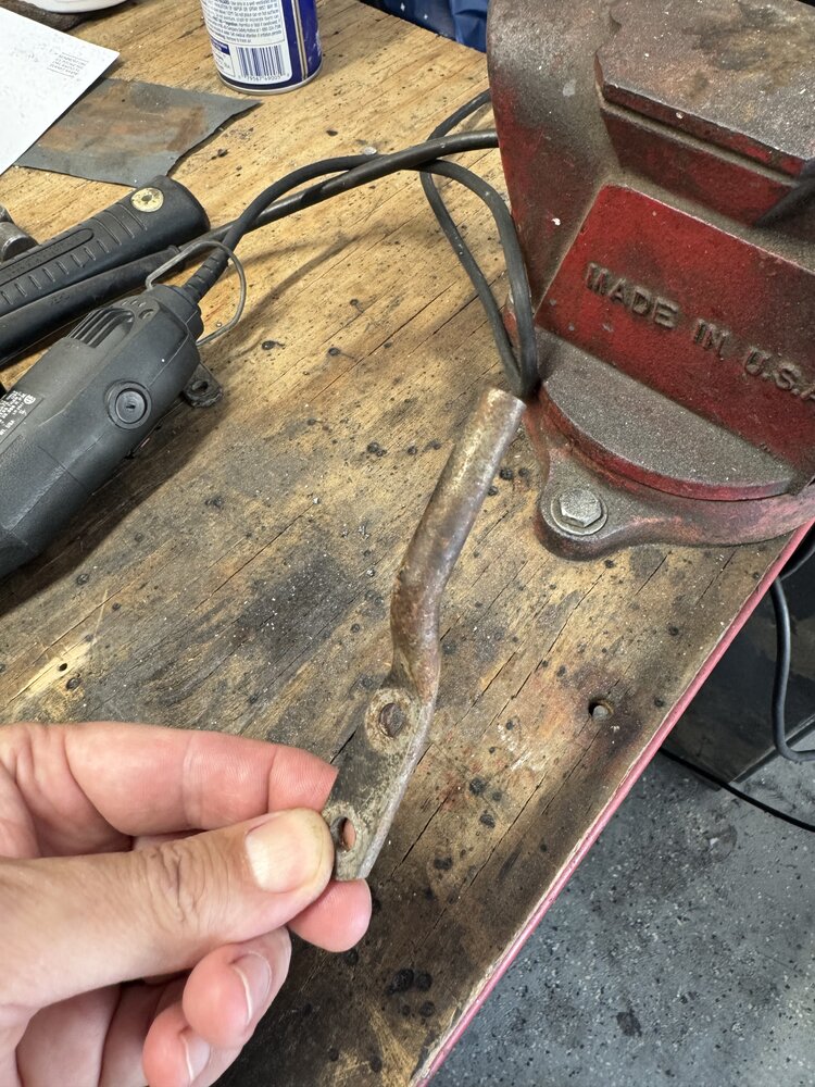

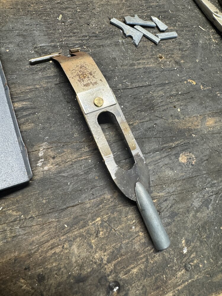

Well, if you can’t find the parts, make the parts.

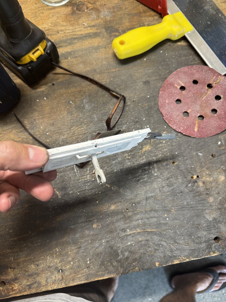

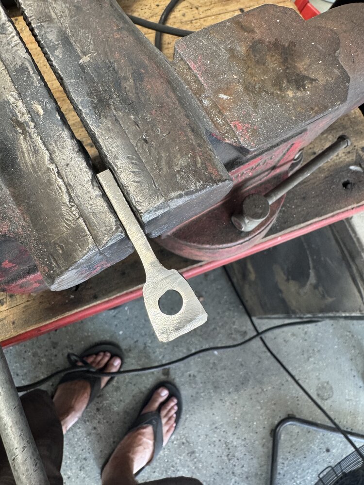

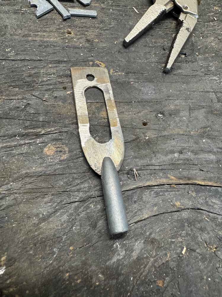

First to make one of these levers:
Anyone recognize what I’m starting with?
A little crude, but I have Mapp gas torch to heat and bend, an angle grinder, bench vice, Dremel and drill.

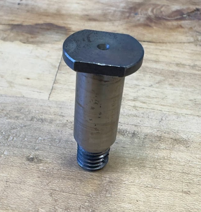

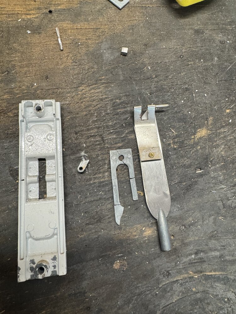

Next to figure out the pot metal connector piece.
