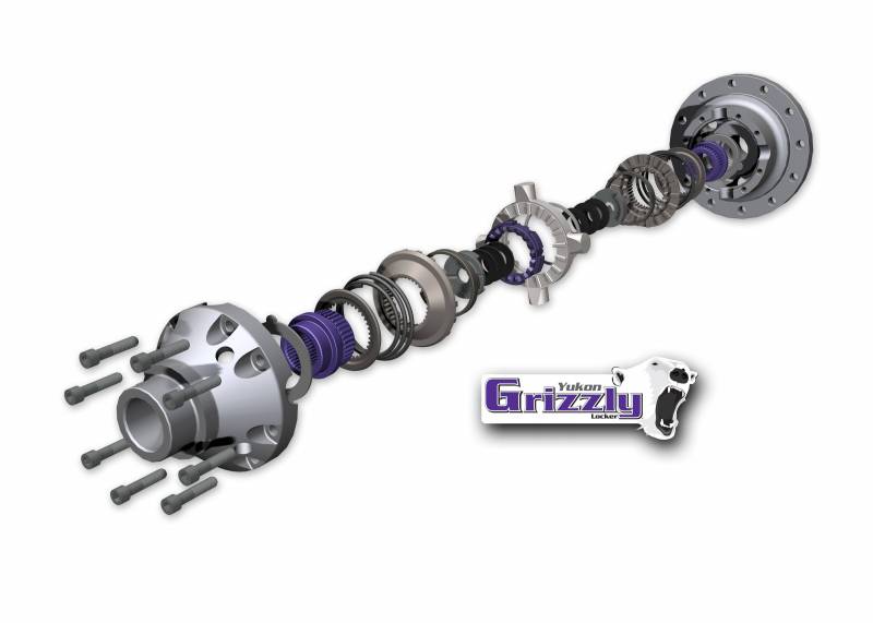

78 Chevy Dana 44 FRONT. Grizzly locker. Broke axle shaft on Dicky Bell! Broke right at splined section in diff…tried unsuccessfully with magnet to pull it out. Friend “thinks“ I can pull axle on other side and push out the splined piece. Is it hollow through the diff and locker??? It’s been a while since I installed it and can’t remember.
You should be able to do just that according to this IPB.
I've been in the same exact situation with a dana 30. I used 1/4 piece of round rod through the carrier to beat the broken piece out.
