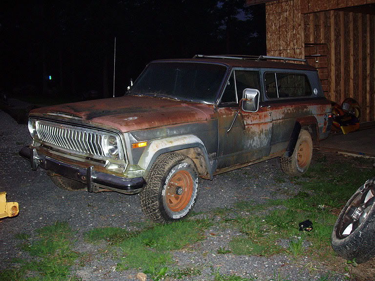

heres a flashback. bought the jeep for 400 bucks and it ran
pretty damn ugly. thats a 77 cheroke btw stock with a t-18 dana 20 and 44's f&r .

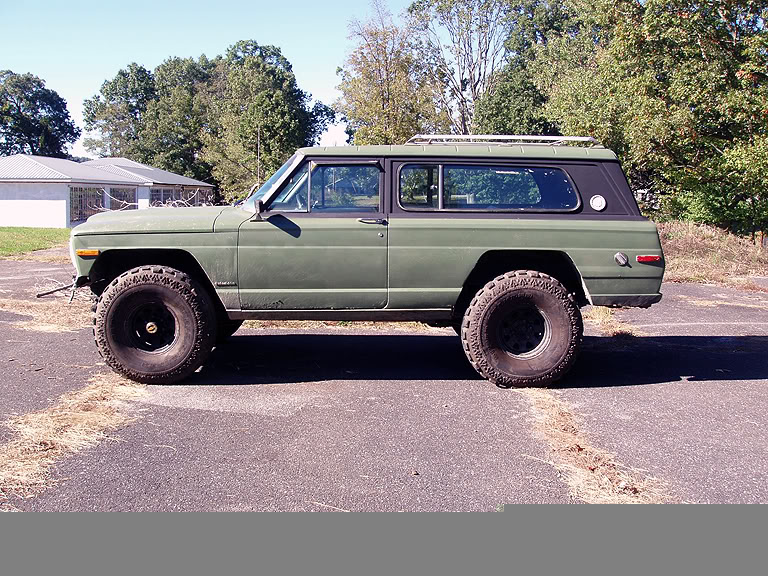

then i discarded all that crap and put a HD44 up front with chromos and superjoints and a 60 in the rear with BJ's 6" lift with 39.5 IROKS, if you seen me wheeling this is probably how you seen me, this stage II setup lasted about 7 months before i imploded the tcase and snapped a chormoly shaft.

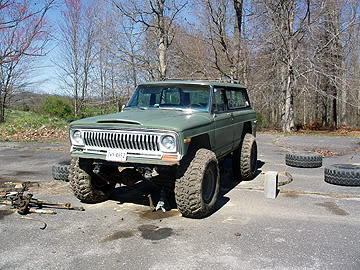

this thing is sopposed to be done by memorial day, if not ill never hear the end of it. any and all ideas and comments are welcome. more pics to follow with progress as of now the jeep looks like this

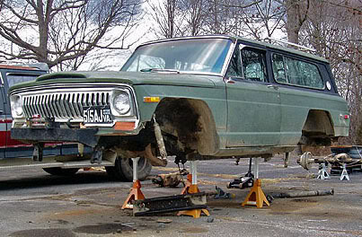

Is it still sitting on those Jack stands after the wind we had this weekend? :D
haha the jeep is actually in my garage now. i bought a house between that picture and now so its not goin anywhere .

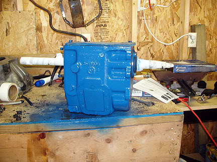

i did manage to get the centerforce clutch, bellhousing and transmission installed finally.
ai86.photobucket.com_albums_k105_visualinhalant_FSJ_20break_20and_20build_fsjbreakandbuild18.jpg
it went pretty smooth and i painted the thing ford blue, dont hate
ai86.photobucket.com_albums_k105_visualinhalant_FSJ_20break_20and_20build_fsjbreakandbuild21.jpg
workin on the crossmember right now so i can install the t-case after i fix it to be twin sticked

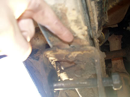

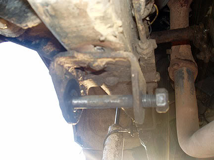

problem i need to fix, the frame is cracked under the rear spring hanger on the front springs.
ai86.photobucket.com_albums_k105_visualinhalant_FSJ_20break_20and_20build_crackedframe4_1.jpg
ai86.photobucket.com_albums_k105_visualinhalant_FSJ_20break_20and_20build_crackedframe2_1.jpg
would a piece of angle on the inside welded up siffice this crack? it seems the rivets holding the shackle hanger had pulled thru. im also outboarding the springs up front for my dana 60

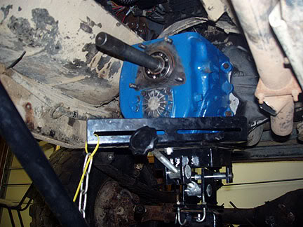

made a little bit of progress this weekend. took my 205 apart to twin stick and freshen up, also notched my crossmember out for the 205 tranny mount. gotta weld that up and im good to go on the drrivetrain.
