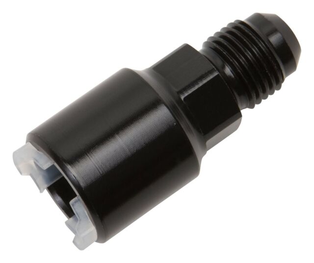

For fittings and hose, go with ethanol approoved braided hose and fittings FROM THE SAME COMPANY. Russell, Fragola and others sell quick connects that attach to the OEM fuel rail that have a AN threads on one end.
Here's a pic of the fuel rail fitting. You'll need a 3/8 and a 5/16.

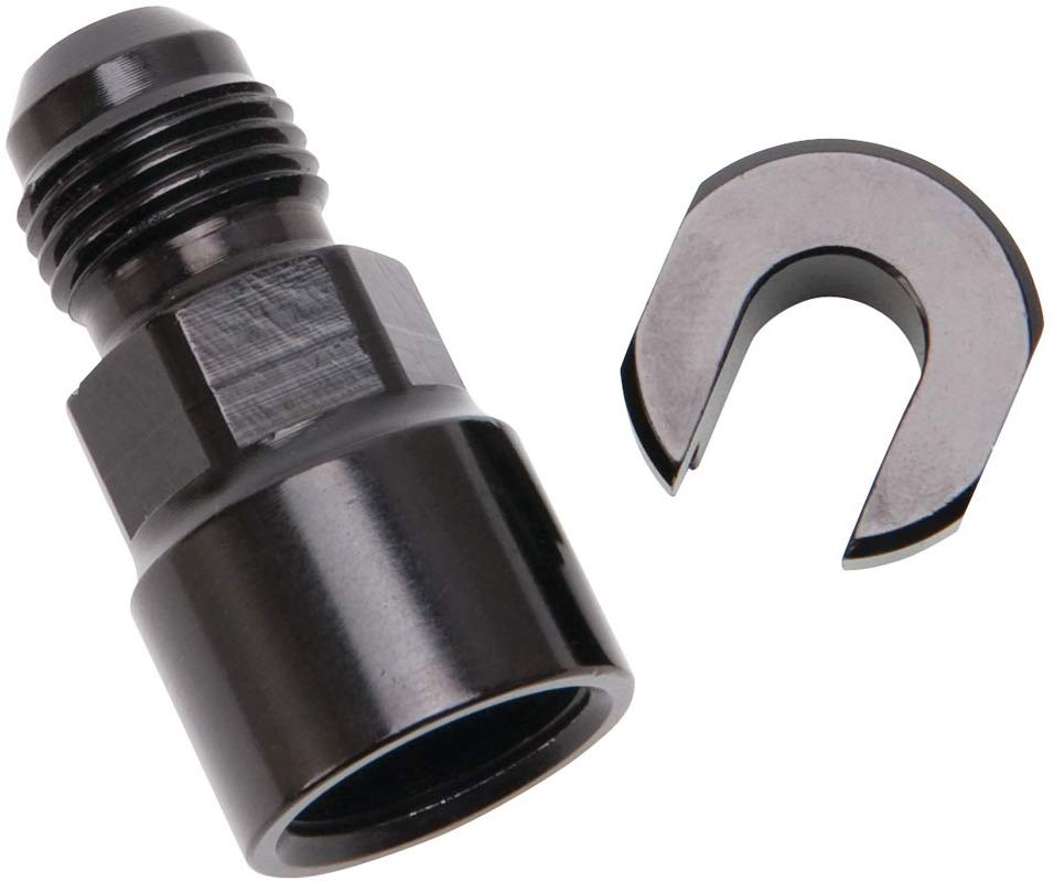

I'd suggest a fuel rail adapter with a metal locking ring instead of the plastic clip on deal. Easier to install remove (no need for the special tool) and it's also safer IMHO (heard about a few people having issues with the plastic retaining rings not holding up in the long run).

I've not really had much issues with the chryco quick connect - no tools required to remove, just pinch the tabs. Later models used the ones with metal retaining ring that requires the disconnect tool. Ymmv
