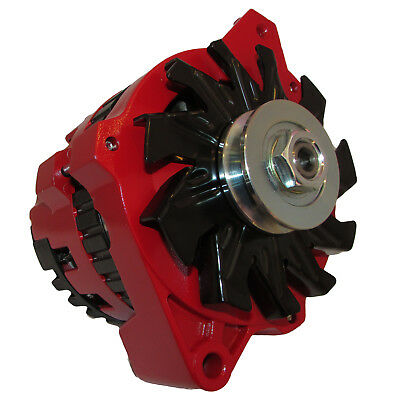

I grabbed one of these for a dual battery winching setup and it has worked fine.
