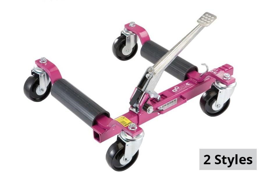

Messing around with skates or skids on the highway closest to the fast lane is one of the last things you'd want to do. The mass majority of our highway calls get put on roll back drivers because the conditions aren't safe enough to allow wheel lifts (wreckers) to put vehicles on dollies on the side of the road. So long as it goes in neutral, a roll back can get it alot faster and safer.

Those vehicles after getting them in Neutral get skids, what goes on the bed has to come off at some point and messing with a locked parking brake is the worst when unloading; The rolls backs don't have as long a winch line to snatch block vehicles off.
