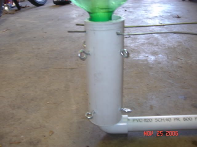

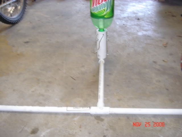

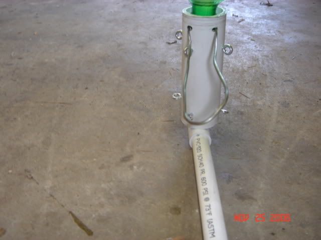

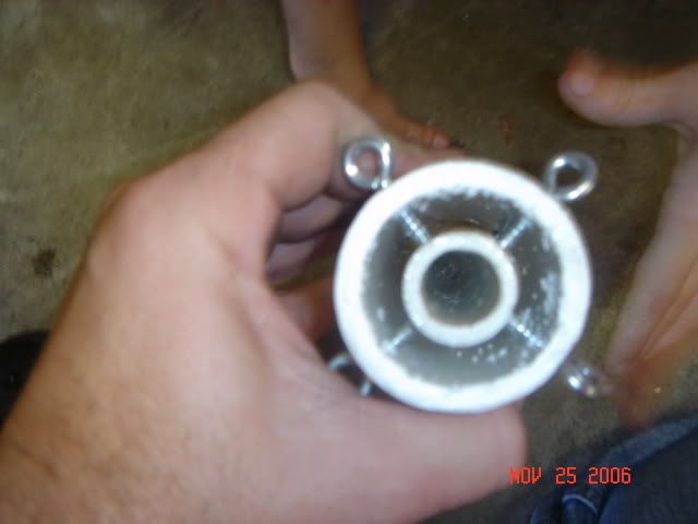

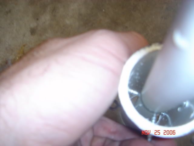

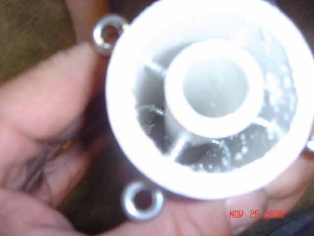

That might be a neat project for my son for science next year. This year we just made a water bottle rocket. I use a tire pump and it will launch a 2 liter bottle clear over a pine tree. I haven't added and thing to keep it flying straight or a nose cone. I just wanted to see if it would work first. It is so neat how compressed air and water can propell the bottle over the trees. My son got real excited after the first launch. It is cheap and the only hard part was making a groove inside the internal tube for the oring to seal the 2 litter bottle. Definitely something cool for a father and son project. Not trying to steal your thread just adding to it. I like your s and might have to try and make one for next year.
Heres a couple pics of the set up I did.
