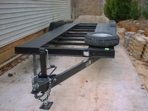

Got my new craftsman trailer... Very please.. I need to do a few custom tweaks but overall its exactly the way i wanted it..
Its 22'
5" channel/5" tongue
6' dove tail
open center
6k axles brakes, 16" 10ply radial tires

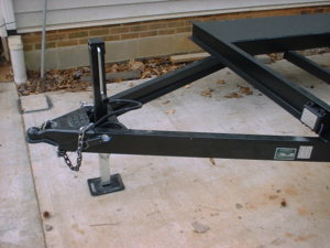

pulled tongue out little bit more for a bigger 'patio' for the camper.
Drop leg behind the coupler for more room to open the camper door.

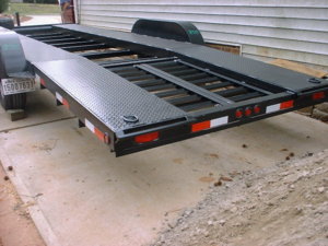

Ramps in a tray in the center. With pin to secure (and lock) ramps in)
Rubber mounted lights recessed in the rear cross member.
It weighs 2750 w/ ~300# tongue weight, tracks great. little bouncy with no load...
Very please with it..
Plan to make basket for tire in the center, its 40" wide..
That thing is RIGID, too... very little flex even when you jump on one corner...
