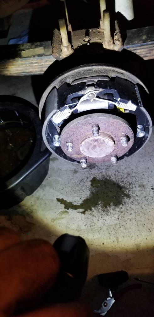

I'm hoping for the wise guidance from yall.

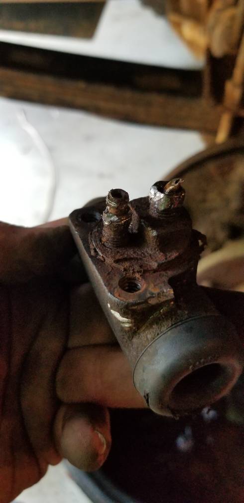

How do you undo fittings on hard break lines with out twisting the shit out of them?
I'm two for two with having to replace them because I couldn't get the fasteners out with out twisting the line to hell. One of the fittings was already rounded.
If the tube nut is seized to the line. Well. You're screwed. you might get lucky with pen oil and a torch but my best bet is to just replace the whole line. I do not own line wrenches. Vice grips to break loose, open end wrench after it's loose. All the line wrenches I've used are just good to round off the line nuts (spreads and slips like an open end)
That's what I figure. So on the bright side my rear axel is about to have all new hard lines lol.

@a_kelley is right, once the tube seizes to the inside of the fitting, that is all she wrote, by the point that much rust has taken hold, it is a good bet you need new hard lines anyway.
Glad to read I not the only one who has never once successfully used a line wrench!
By the looks of that mess new is needed.

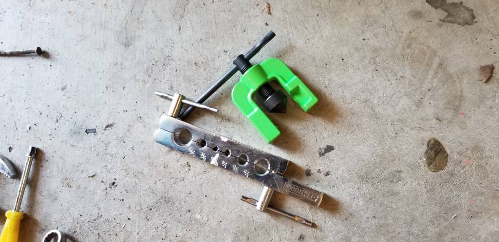

All of this has been really helpful I'm about to make another run to the parts store to get new hard lines and a flare kit.
Get a bit of extra and practice of you have never made any. Also buy the softer line.
And get ready you'll flare at least one line and forget the friggen fitting!
I got a stupid little sticker plastered on my flair tool box.......reads: fitting stupid, fitting first.

Just got back from autozone. Finally bought line wrenches, got two new lines, flare kit, and an extra fitting.

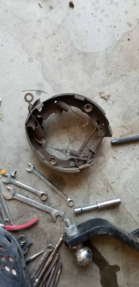

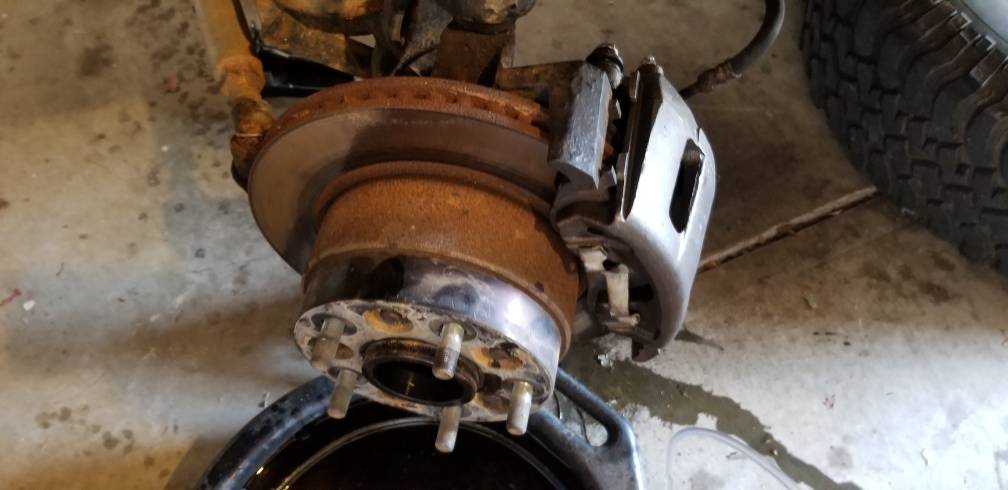

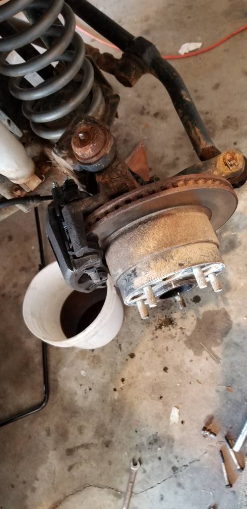

Got everything but the front tires back on. Realised while doing my front calipers because the bleeder valve was rounded that I need longer front brake lines

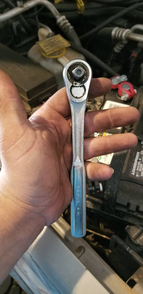

And I busted my favorite ratchet. It came apart of the first tool kit I ever got about 4years ago
Go exchange that ratchet.. lowes started carrying Craftsman.. or Sears or Kmart. I've got a few of those myself. Oh and if you use niCopp or the steel line, I can bend 3/16 perfectly with just my hands, now 1/4" and larger I break out a hand bender.
Yeah I may or may not have used that ratchet in my hilift handle as a breaker bar. I have a 1/2 breaker bar but just two sockets for it.
It think for now since im cheap and just spent more than i budgeted for I'm gonna exchange that ratchet and get 1/2 to 3/8 adapter. I picked up a decent ratchet from advance auto when I got calipers.
