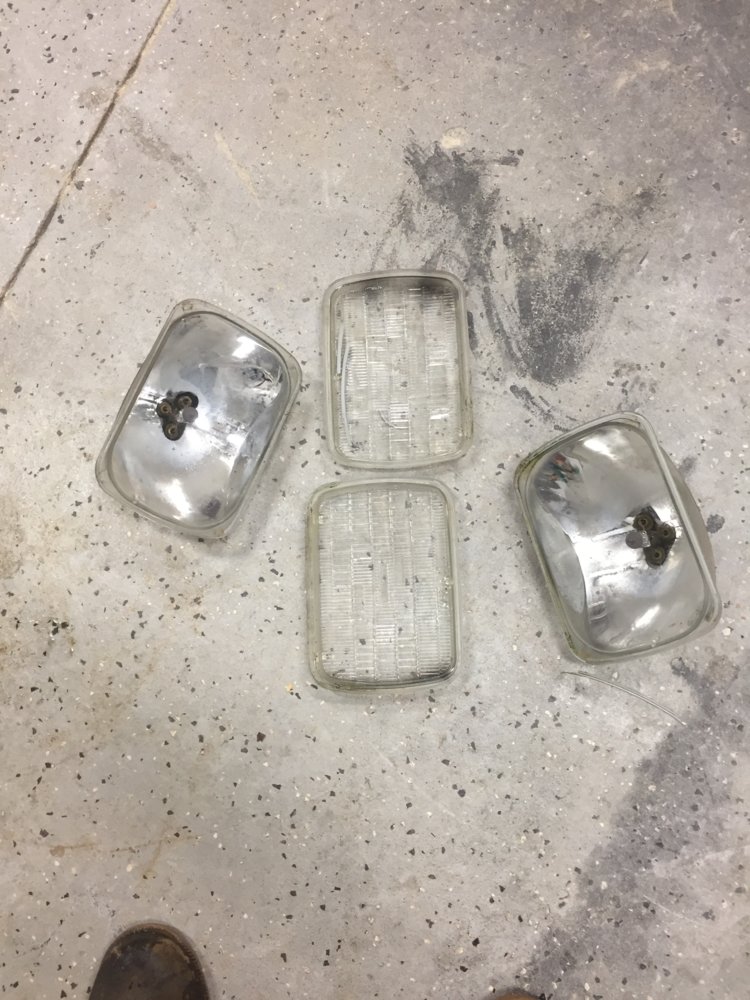

Im looking to upgrade the old 6054 sealed beam headlights on my 94 pickup. Torn between LED or an H4 housing.
H4 housing and bulbs are cheaper for initial buy and cheaper to fix.
LED is less amp draw and seem to be brighter.
What have y’all done and recommend?

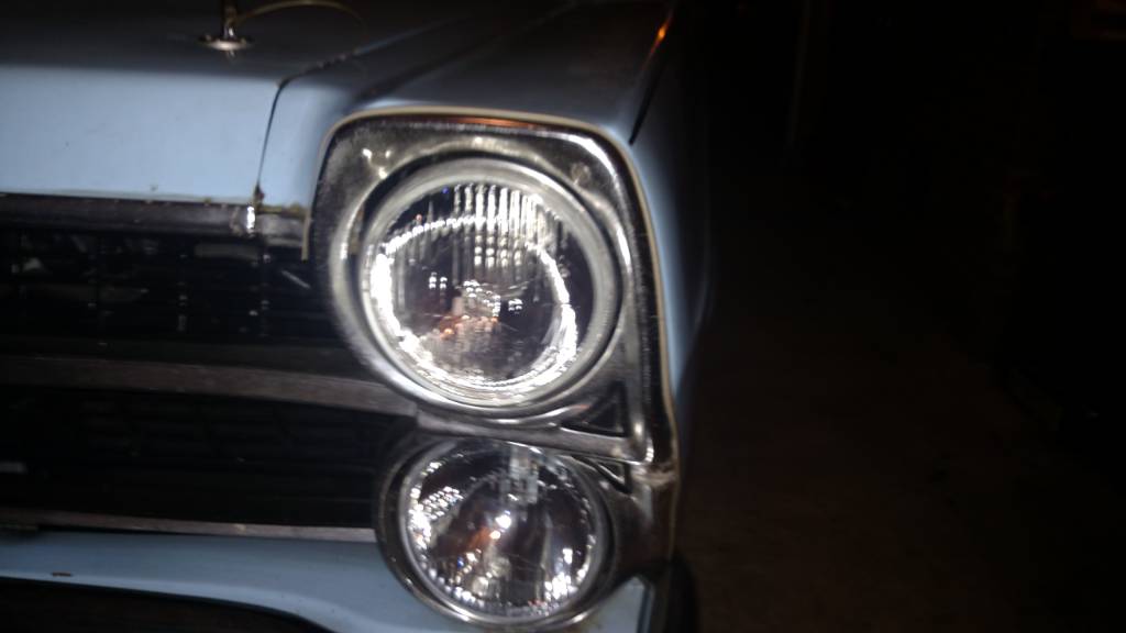

Another h4 conversion recommendation here. Did it to my fairlane and dads c10.

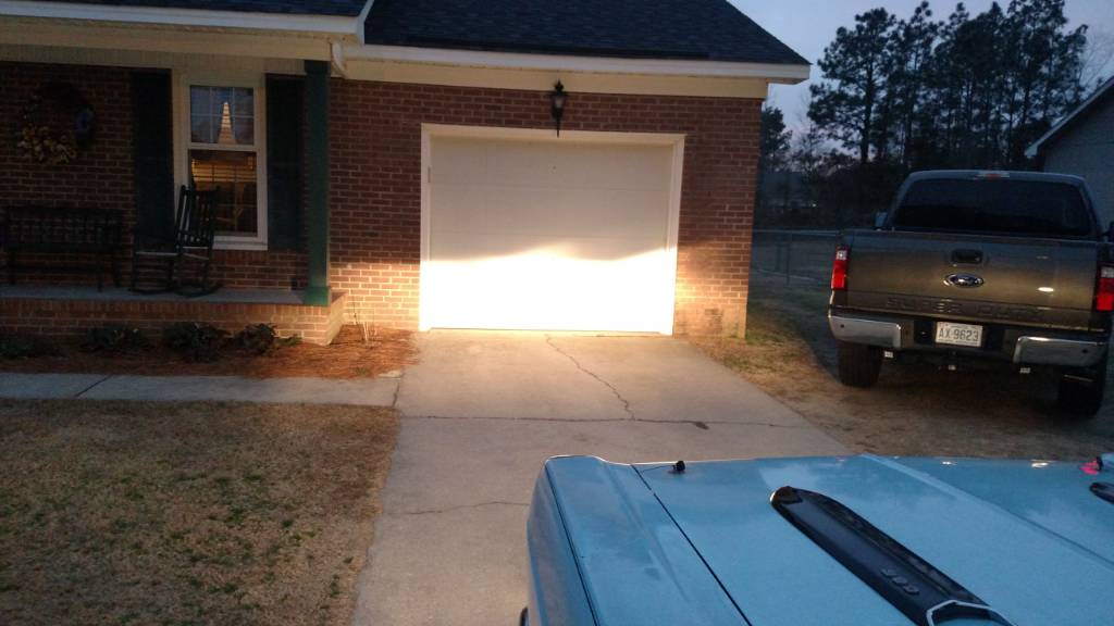

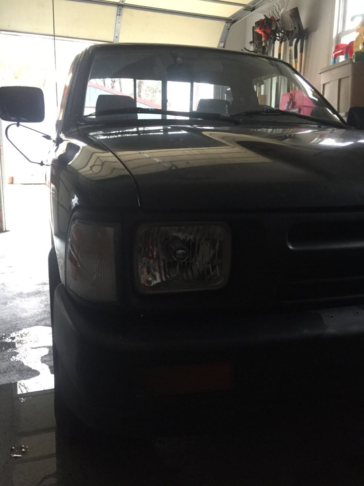

The relay harness by itself made a huge difference on my 87 4runner, looking forward to your results.

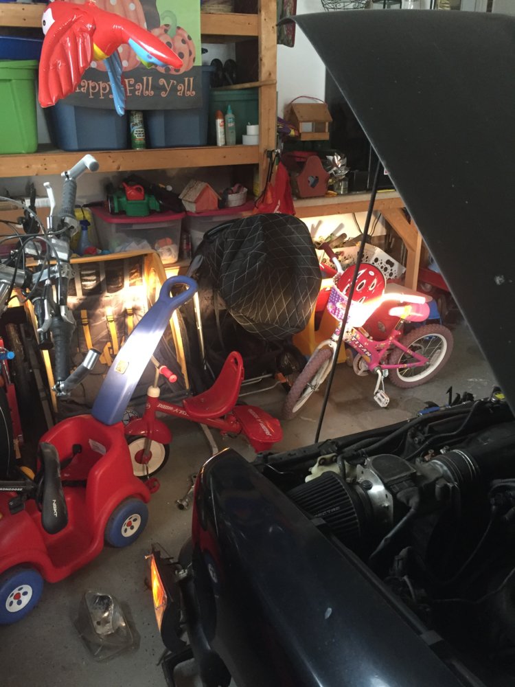

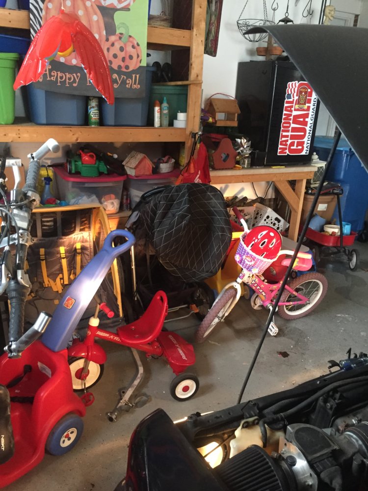

Crappy pics but you can tell the difference on my daughters bike basket and that blue handle. This was just on the battery, truck wasn’t running. Sealed beams weren’t very sealed anymore.
