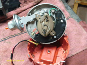

I'm preparing to put a new ignition and TBI in my little red CJ-5. The first thing I need to know... does anyone have one of these distributors, and can you tell me what the module (under the rotor) looks like? I need to know if the module has a pin on it that I can pull a signal to fire the injectors. This will be going on an AMC 304 V8.

I have what looks like the same thing that I put on my 350 with a TBI and it works. It is not that exact one for obvious reasonsm but I can say it started on Sunday!
Don, looks like I have the same Dist. Bought it from a member,a year ago, who purchased it off E-Bay. [$100] I haven't installed it yet, should have given it to James, but he has enough to do.
As I understand it, mine is a 1 wire hook up. Didn't get any harness, but it has 2 blades, one for ignition [12v], & one for a tach. If I understand what your asking, the module has 2 wires, into a blade connection.
Green,& Gray. Hope you can see in my pics.

Thanks guys... Rodney's pic is showing a 4-pin module which would have to be replaced with either a 7-pin or an externally mounted 8-pin module. This is what I wanted know though... Thanks again. :beer:

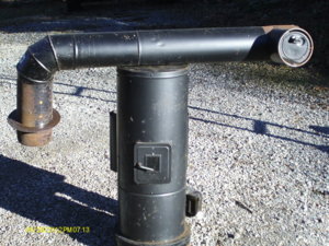

Got just what you need! Actually have it on Craigs List! [hint hint-anybody?]

Rodney, you should bolt that contraption to your new axle... might help you plane out in a mudhole situation! :flipoff2:
