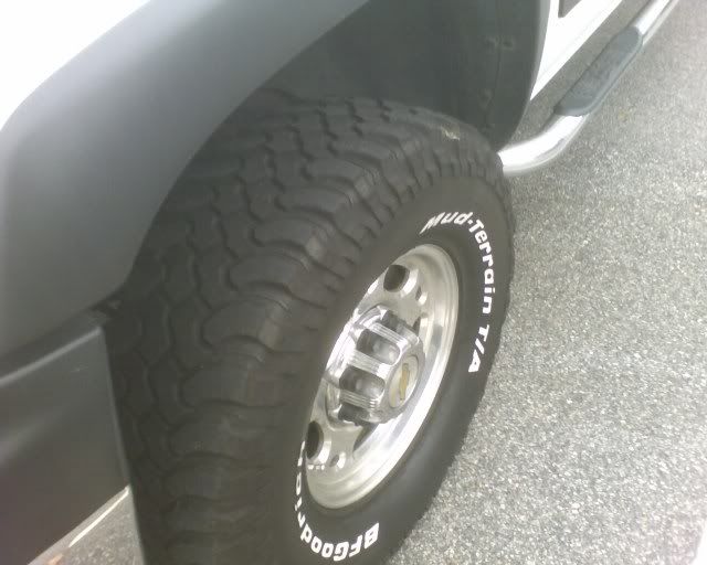

Just a thought, these are my KM1's after 45k mi when I first listed the aluminum wheels for sale. The fronts had about 1/4" above the wear indicators, while the rears had about 1/8".
http://i44.photobucket.com/albums/f43/GCncsuHD/wheels/CID__10-11-06_1228.jpg
Wound up riding on them another few months until about 50k mi before pulling them and getting the wheels sold when I put on the lift.
This was with keeping up with rotating every oil change, and riding with ~38psi normally to reduce crowning and for a better ride, and 65psi when towing or hauling. And keep in mind it was a heavy 3/4 ton truck.
Mine were 285/75/16, but I paid right at $800 for them, I'm sure prices have gone up a bit, and 17" may be more, but I'm sure shopping around you can get the set right at $1000.
