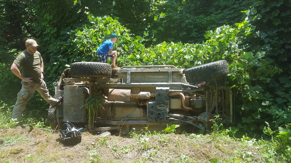

Friends XJ flipped on flat ground area in hot springs area on 25-70. About 5 miles past hot springs towards Newport.
Hoping someone can follow me and his friend (who was with him). Just need to flip it and it should be able to drive out after oil settles. Didn't roll and no drivetrain damage so I've been told.
He's a firefighter and stuck on a 48-hr shift so hoping I can find someone to help. Otherwise I'll just use my Jeep and a couple of tow straps to try and get it flipped.

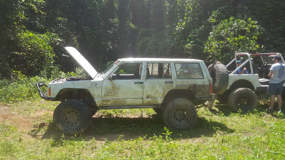

Thanks for all the comments guys! I appreciate them! I was able to hook tow straps up to the rocker and bumpers and yank it right side up, and then use the rear wench to pull it up the ditch. We pulled the plugs and let sit for a bit. Were a bit gaumy so put in new plugs. Checked the other fluids. It fired right up and was able to be driven home.
heres a pic of yours truly, Mr. Fatty and my minion.

Here's another pic. My jeep's maiden voyage on its first trail haha
