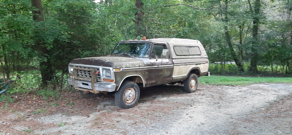

I appreciate all the help. Messed with it today. Turned the idle set screw to get it to idle without the choke, sprayed syrarting fluid and found a vacuum leak. 20 yr old brake booster hose...dumbass. Anyway, also decided that I needed to check the timing since I never did after having the distributor out. Couldn't find the timing marks, so I turned it a little till it got better. Ugh, moron.
The plugs are probably junked, the carb (Motorcraft) definitely needs replaced, the brakes are crap, the tires are dry rotted to hell, but it moves and half ass idles. Still probably going to pull and check the intake just to know it's usable, I'll clean up the balancer so I can ACTUALLY set the timing, do a tune up, and see where it goes from there.
Picture just because
