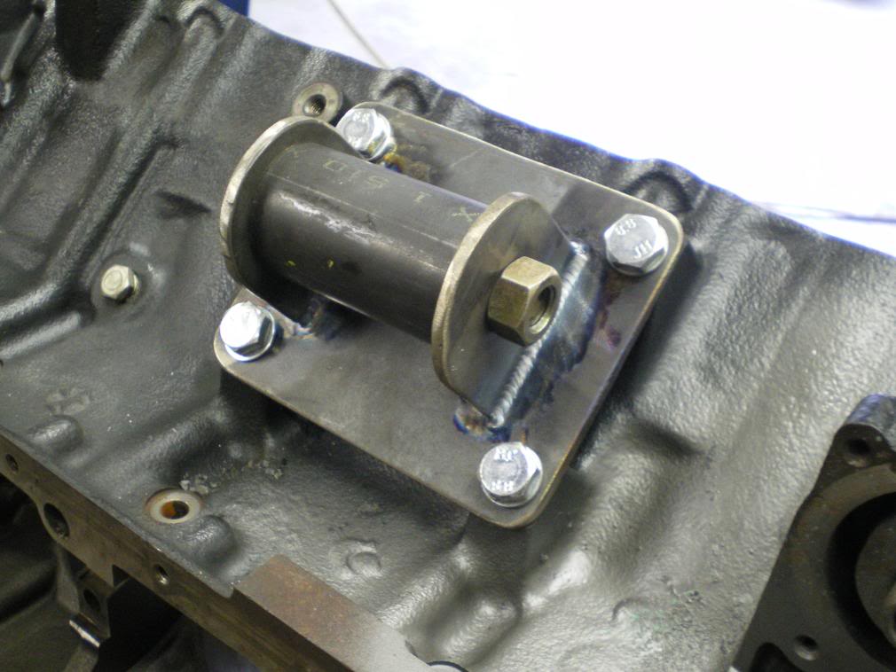

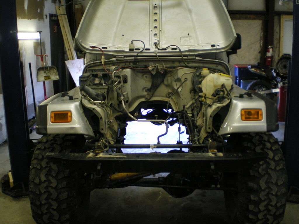

I just finished this swap the other day. Its a 2004 5.7 Hemi motor into a 2005 Rubicon. I used the 545rfe automatic 5 speed transmission along with a custom wiring harness to maintain emissions legality and retain all the original dash gauge and light functions. The motor and transmission was rebuilt by myself and i installed a HD2 shift kit in the trans and a comp cams xfi cam in the motor.
It also utilizes an electric fan, custom crossmember to eliminate the skid plate/crossmember, custom motor mounts and exhaust.

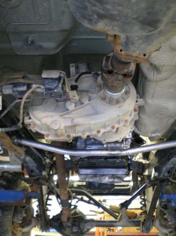

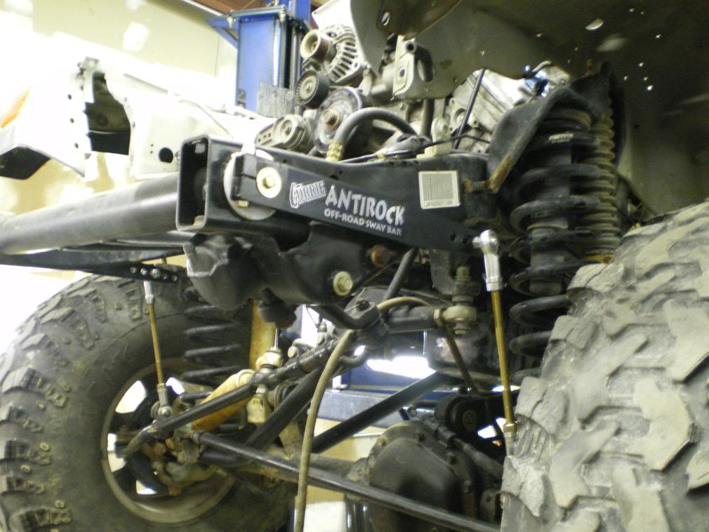

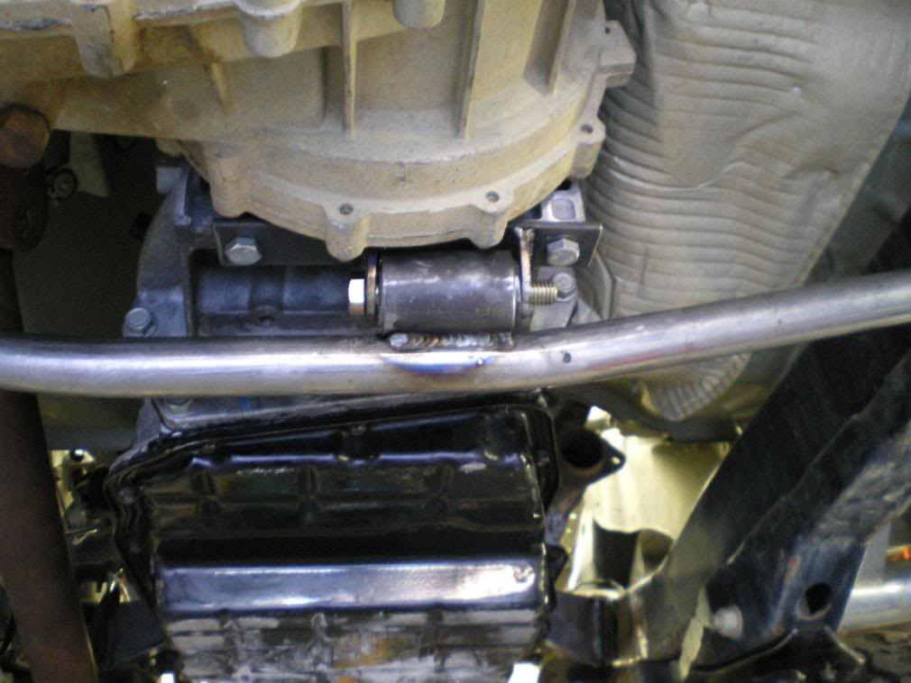

Am I seeing that correctly, that the crossmember is welded to the frame, and then the driveline bolts to it?

if it is welded to the frame he would not be the only engineer to do this, many factory trucks are like this, i think GM is hiring.

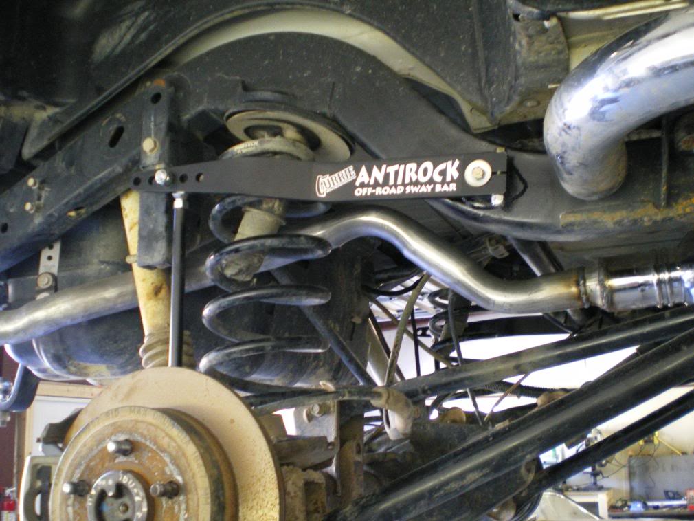

The rear cross member is not welded to the frame, its bolted to the inside, and then the transmission mount bolts to it as well. Its a fully functioning crossmember that can be removed
Also the tube that is welded to the frame behind that is the housing for the antirock sway bar, not a cross member
