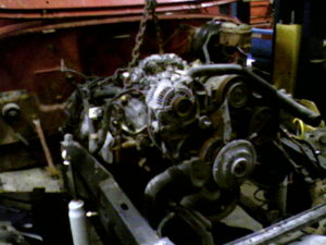

anyways here are some crappy progress pics. as some of you know my jeep started life as a 2.5 4 banger, I swapped in the 4.0, wasn't happy and wanted more power, so here comes the 5.2

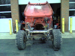

its sitting in there now, I used the novak conversions Motor mounts, which to say they fit like crap is an understatement, but with a few minor mods I got them to fit well and I like the fact they alow me to raise and lower the engine if I choose to do so

ordered the clocking ring an adjustable fuel pressure regulator yesterday. Plan on a completely flat belly that goes from front spring hanger to rear spring hanger. Also I am hoping I can use my stock 4.0 fuel pump with the adjustable fuel pressure regulator
nice. keeping the 318 stock or what? what trans? 46re?
Lee appears to be building his rig at work.:shaking:
I'm probably gonna regret this but it is the Monro Muffler Brake & Service on hillsborough rd.
Now get back to work Lee and make me some money.:huggy:
Just Kidding, looks good and man you work quick.
I did the actual motor swap at work, the jeep is now back home where I will do all the finish work.
Motor is stock for now, I am gonna start with the free mods such as cutting down the intake runners and doing a port job on the stock throttle body, after that,
I will see how I like it and possibly add headers, 52mm throttle body, M1 intake, and 1.6 RR down the road, I have those things done to the motor in my Ram (along with a few other secrets :) and the fact it is a 5.9, or used to be :huggy: ) and it runs very well
As far as the tranny it is a 44re, I will see how it holds up also and maybe swap in something else down the road. I got the drivetrain dirt cheap from a wrecked 97 grand cherokee so I am gonna see how it does to start and work out the bugs from there
