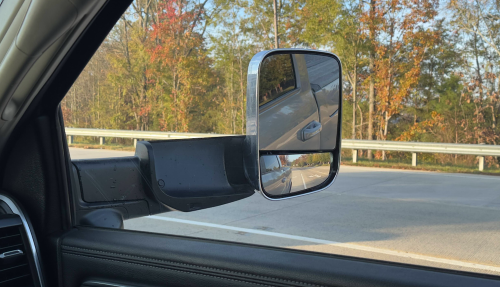

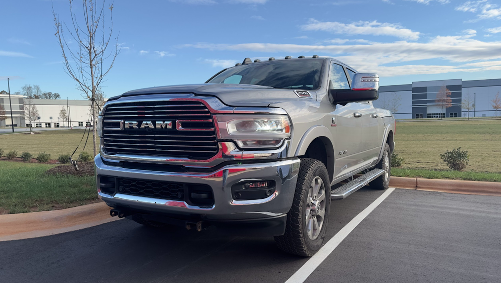

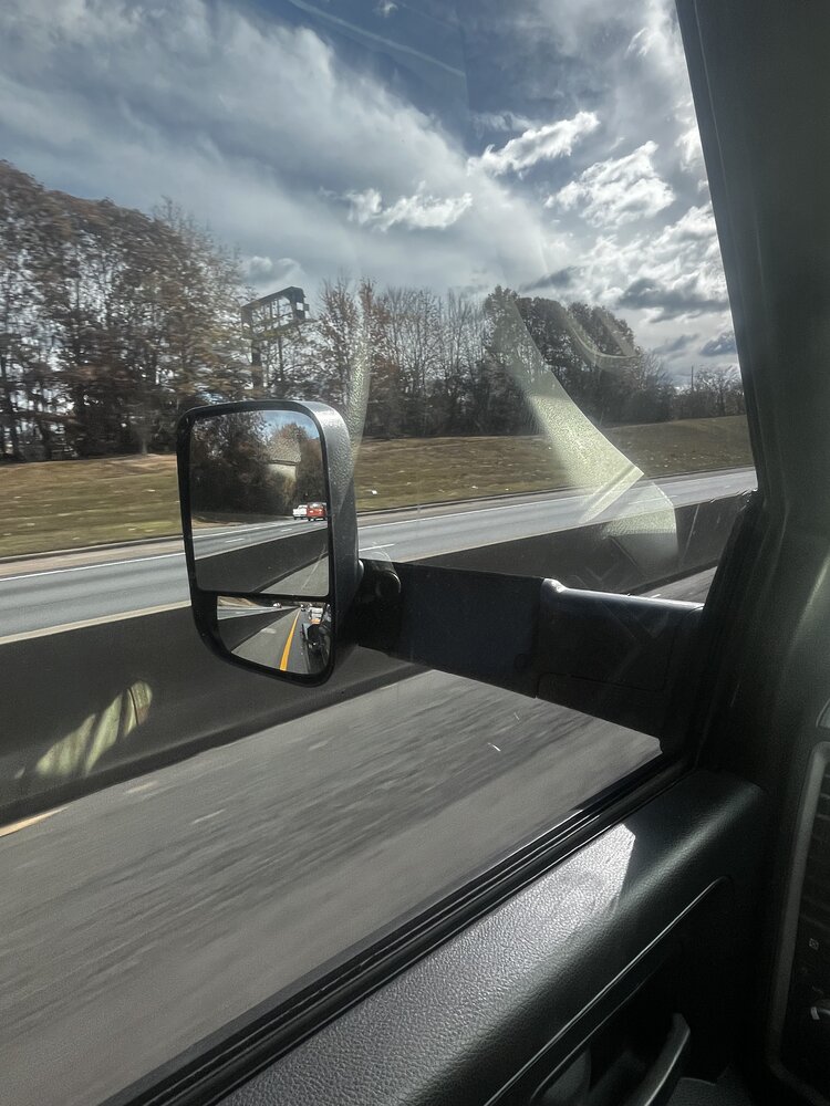

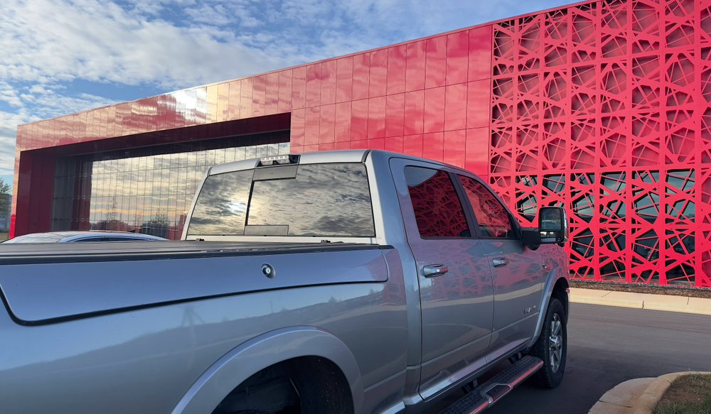

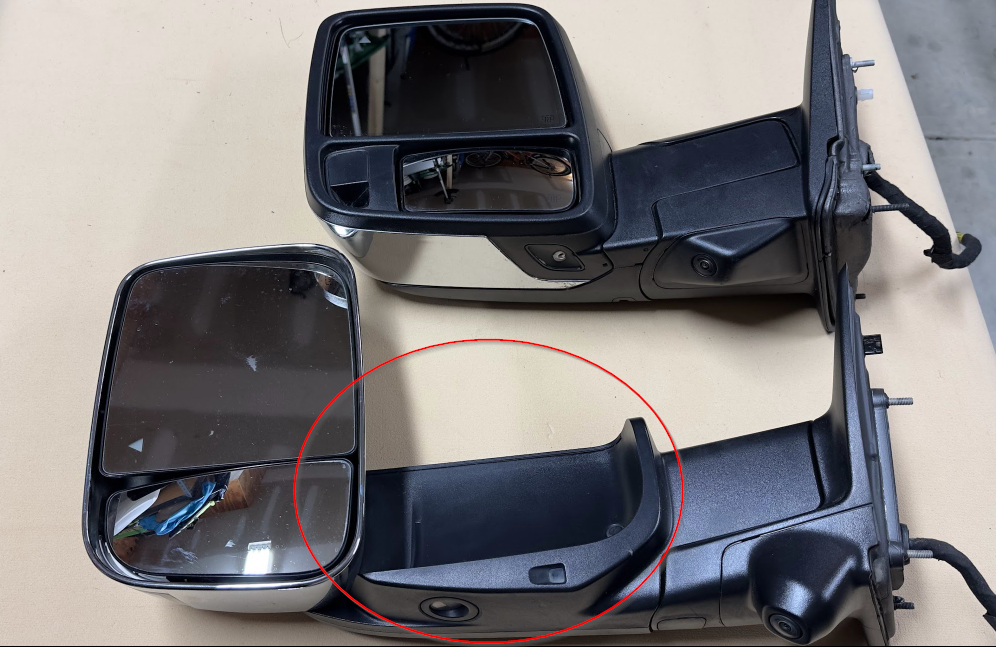

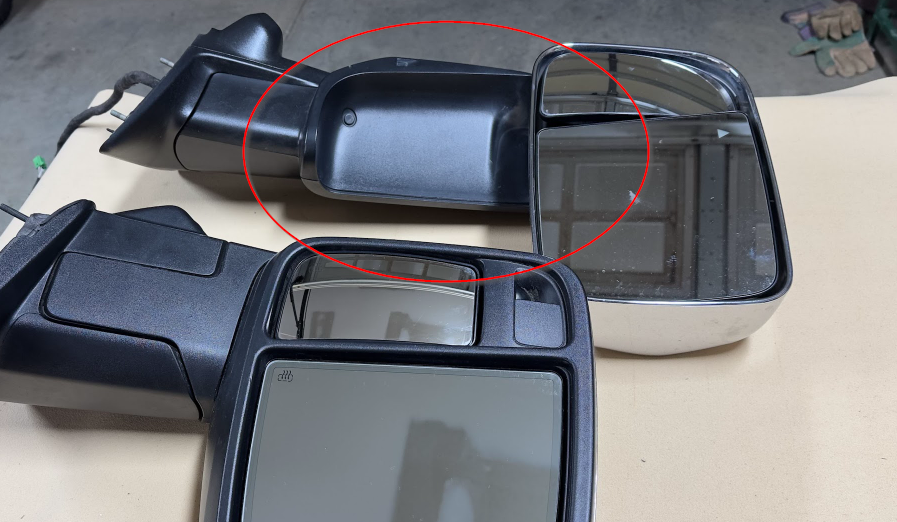

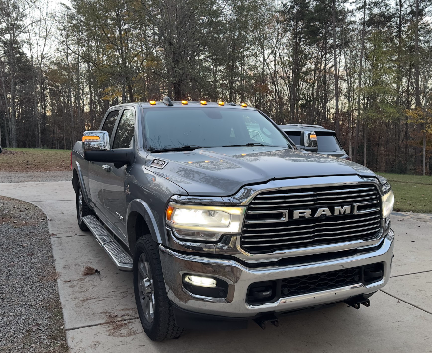

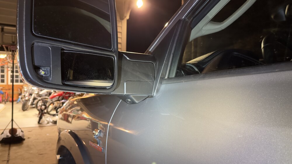

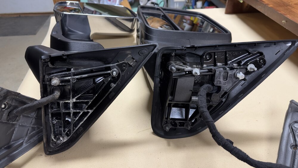

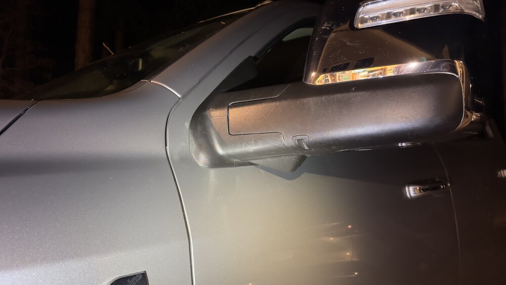

FYI, Ram has new mirrors on the HD trucks in 2023 and they can be installed on the 2013+ trucks, maybe older ones too. Takes a little modification to either the door or the mirror. Old mirror has 3 bolts, new one has those same 3, plus 2 more on the bottom.
Write up on my swap here.
