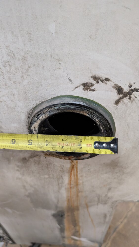

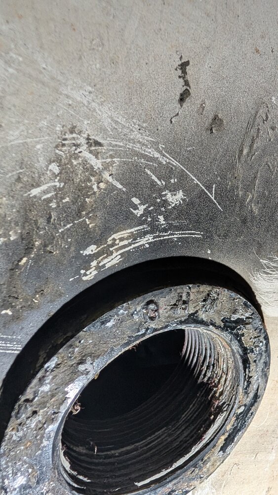

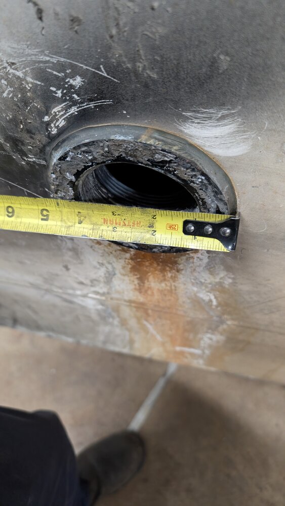

Fiberglass tank. Has epoxied threaded bungs. Threads are crossed up and damaged by very corroded fittings removed.
I have used some sort of double flanged fitting with gaskets in the past. I can't seem to source what i need. Willing to use parts in a non traditional way if a combination applies.
Ideally the flange would allow bolts outside the removed unit. A inner backing flat flange. Gaskets for both sides. And one have a 2 inch FPT and another unit for 2.5 FPT.
We have some room to bush if a larger pipe flange is required to get into clean tank wall to drill.
Tank is fiberglass approximately 1/4 thick.
I have done this repair before many years ago but i don't know what I was supplied.
Edit. These are supply and one recirculation line. Not a pressurized situation or a place dead head pressure would be applied.

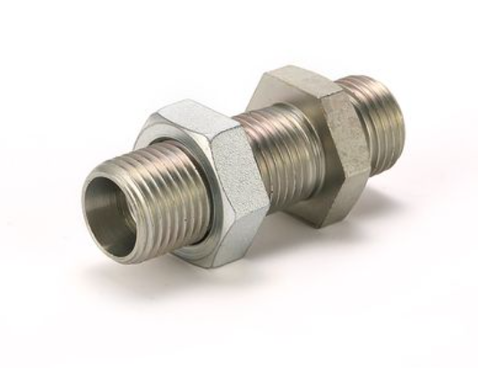

It's a banjo bulkhead fitting, they make several styles. I might have some 4" ones laying around
If its like what is posted below they usually fail.
That's why I said banjo brand, the ones you get from the farm store aren't nearly as good.
Banjo 3" FNPT Bolted Bulkhead Tank Flange BF300 | Zoro Banjo 3" FNPT Bolted Bulkhead Tank Flange BF300 | Zoro
Idk what size you need but they also sell different bolt through fittings like that as well.

Much better fitting. The bolt diameter may not get us into clear fiberglass as far as I would like. I have contacted two of our poly tank suppliers. One engineer refused to make us something custom 😆.
The other said sure! As for on and off its a fire truck. One fitting chewed up the thread because it was ate up like the Titanic. The other is stupid access and "others" ruining the thread by several attempts to repair.
