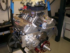

The steering is from the steering wheel down with a couple of u joints to turn around the motor.also a couple of heims mounted to frame with the shafts running thru eye for support. its a manual rack that i had a threaded shaft on ends so i could use 3/4" heims.I left the tie rod connected to the front also for stability and incase the shafts on the rack bend,that way the tires wont colapse in or out...there is a spacer between the heims on the rack and tie rod with a 3/4" grade 8 bolt going thru the eyes of the heims
Actually Steve at SVRE had my motor being dynoed on youtube,not sure if its still on there or not.
