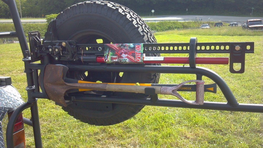

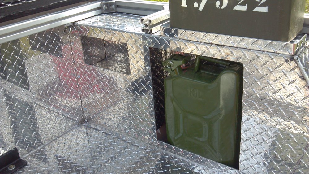

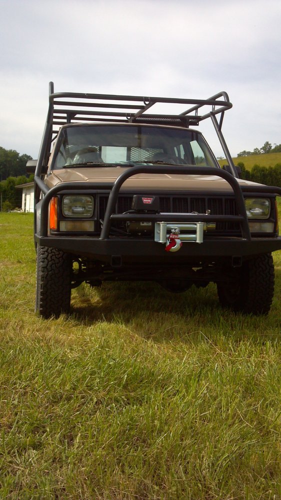

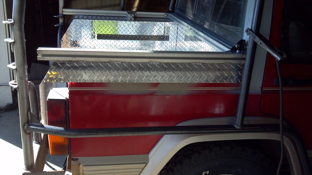

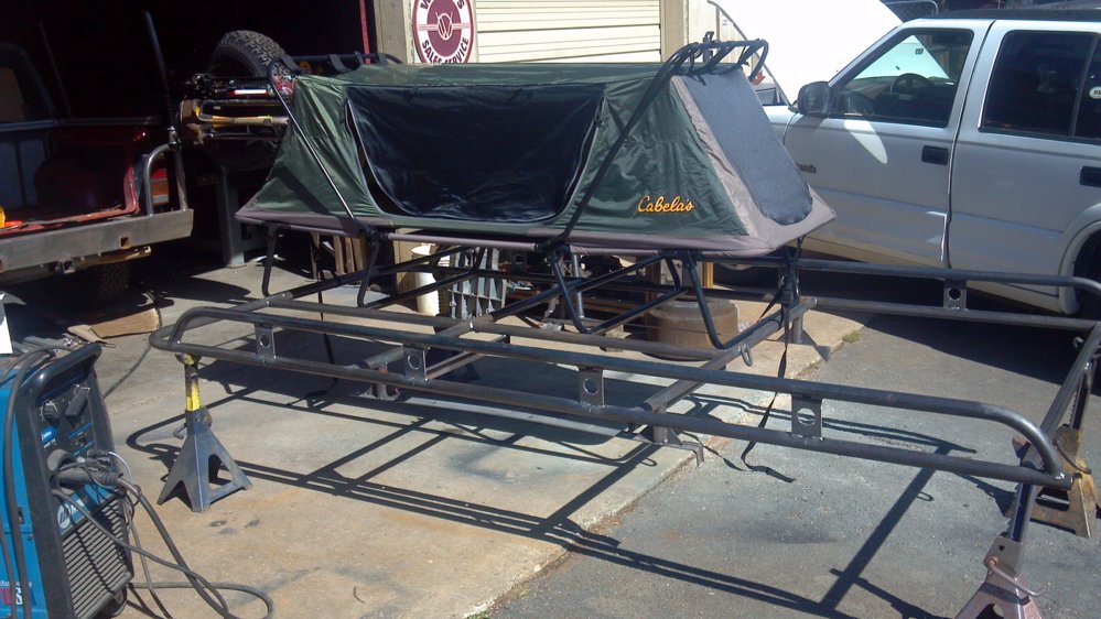

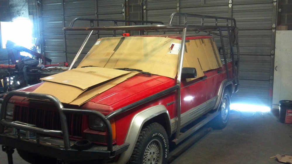

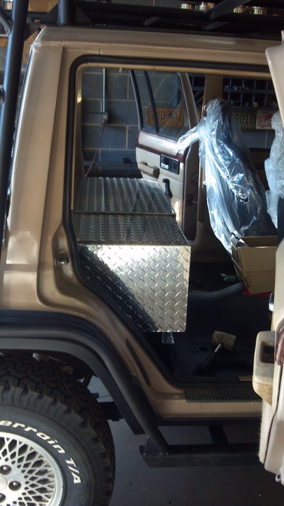

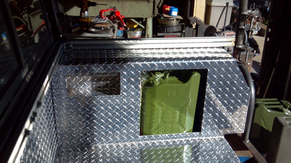

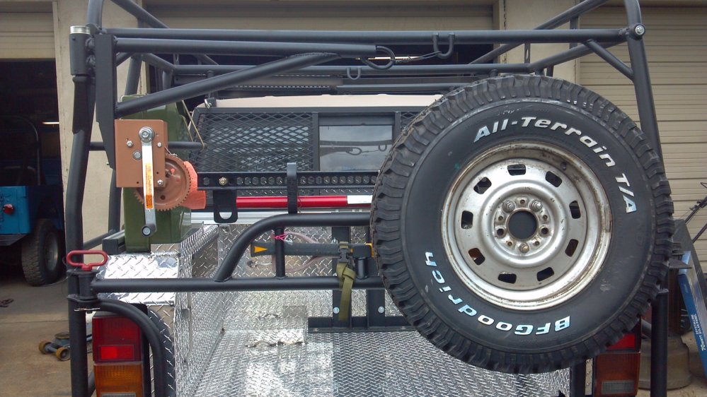

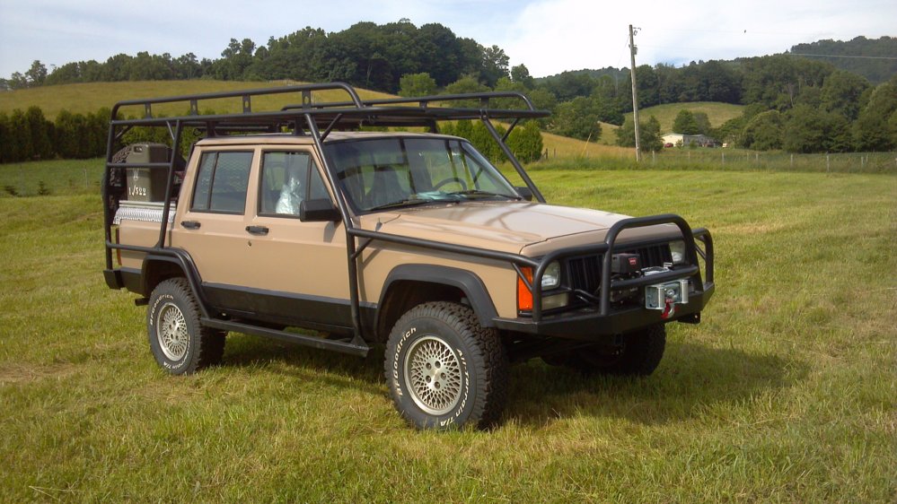

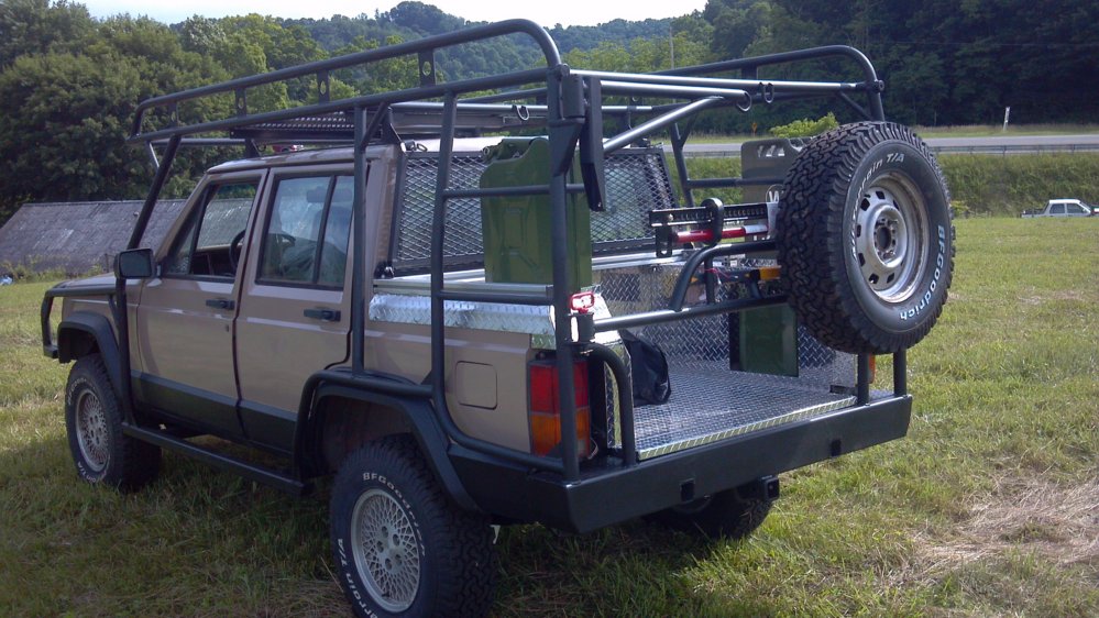

This a custom cherokee I built for an avid hog hunter. It is a purpose built rig for offroad adventurers and extended stays in the south Carolina low country. the "rack" was built in exocage fashion but built to the customers specs as far as how wide d distance from the body. It has a slide in solar panel and cabelas cot tent that fits on top. back has been chopped and rebuilt with a comanche rear panel and a bunch of 1/8 aluminum. a small lift extra springs were added to carry the extra load. A custom aluminum gun box was also added. Finished of with some flat dark earth paint and raptor liner.
Looks like a perfect purpose built rig. I also noticed the hand winch on the back for getting the hog in the back, nice way to save your back!
