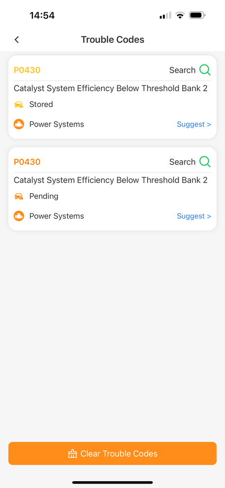

Went to the store and when I got back in the car and cranked it up, the check engine light was on. WTF! Plugged in the reader and got P0430

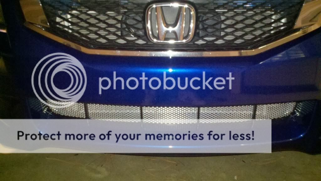

Then on the way in this morning I swear I heard a rock or something hit the car somewhere, then at a stop light I see little bits of smoke coming up from the hood. quick glance at the temp gauge tells me that I'm running on the cold side, not the hot side (no numbers, just an idiot gauge with Cold, Normal and Hot. And it's below normal. See some more smoke, so I pull off to inspect. Engine is basically cold after having been on the road for 20 minutes. I can grab the rad hose and lay my hand on the engine. Then I see the smoke coming from unexpected regions. follow it down and seen green and steam bubbling from the AC Condenser. SON OF A BITCH! this is the second time I've caught a rock in the condenser on this car.
So I'm thinking not only do I have a hole in the condenser, but I have a failed Thermostat. Interestingly, I previously theorised on my Truck that a failed T-Stat lead to enriched mixture which led to Cat issues. Wondering if I have the same damn thing happening with the Honda. That's a crazy co-ink-y-dink if it is!
Anyone ever JB Welded a hole in their condenser before? I'm wondering how much pressure that system really builds up.
