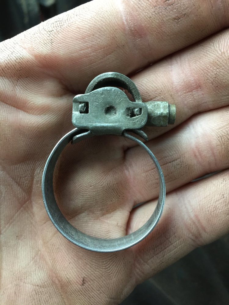

Sure there are screw drive constant tension clamps! They are not cheap nor crappy. There a few bucks each but are better than the spring constant tension style because you don't have to worry about distorting the clamp. I dislike the spring type constant tension and discard after every removal.
Here's the style I'm referring to
They're not your average screw clamp. After you tighten the clamp down, you will have to peel the hose off whatever it's on if you want to remove it.

These are amazing no clue what their called specifically or where to get em tho just had a few on my old truck when I got it and kept em all to reuse!
