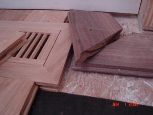

I had a vent that came in pretty close to some border work I'm doing. Most would just cut, nail or glue this section together but not have it locked. The right way is too get all of the wood to lock via t/g
After measuring everything out and using router, the pieces can be reassembled using spline and existing t/g

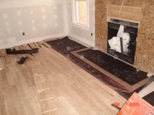

This is the begining of the fire place. The homeowner has a crappy idea for the inside, so I'm not doing it yet. I want them to let me do something else so I'm buying time at the moment.

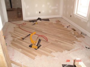

The beginings of the dining room. 2 1/4 white oak laid on some angle, not a 45 I know. It's set up so that the angle will go completly corner to corner. This would only happen if you had a perfect square.
I'll get some more pic's up next week, but this is the only decent pics I have at the moment.
And as far as the swiffer, It was clean when I installed it:rolleyes:
