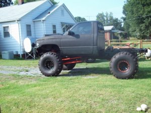

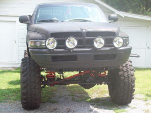

this is my 2000 dodge ram 1500 the truck sitten on 42/15/16 tsl procomp semi beadlock. beds ben doved 16" dana 60 swap in progress with 6:17 yukons detriot lock right front and rear manuel hub conv 1 piece front axel 1tons custom steering setup heims with hydro assest rcd true long arms with rcd trac bar 8 hella 4000 custom roll bar and the list gose on and on with tons off custom fab work done to both axels hope you like

Dude very nasty!! That thing is sittin right! Wish the pics were bigger tho.. work on that :beer:
srry kinda new to this get some more picks. hate to say it but this one is only getting in mudd. i have a beater i tear all to hell this is more of my street queen.
I hope to see that thing around... Definately get some mudding pics (if you dont already have any). Any engine mods?

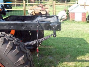

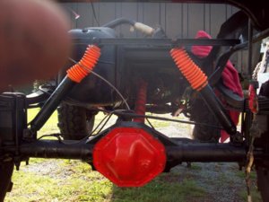

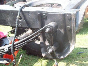

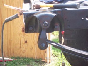

had to take the bed off for the shackle flip and triangulate the rear shock waiting on 8" diesel coil springs for the front

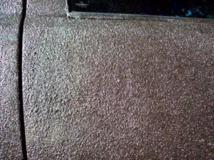

its been sprayed this give you an idea of how textured it is thanks man

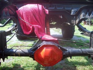

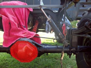

did this today cant tell how much lift it gave me i well know when i get the bed back on should have been 5" but it dont look it

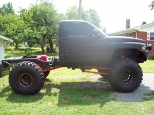

also triangulated the shocks y i was at it looks alot better heims for the hd steering should be in friday
