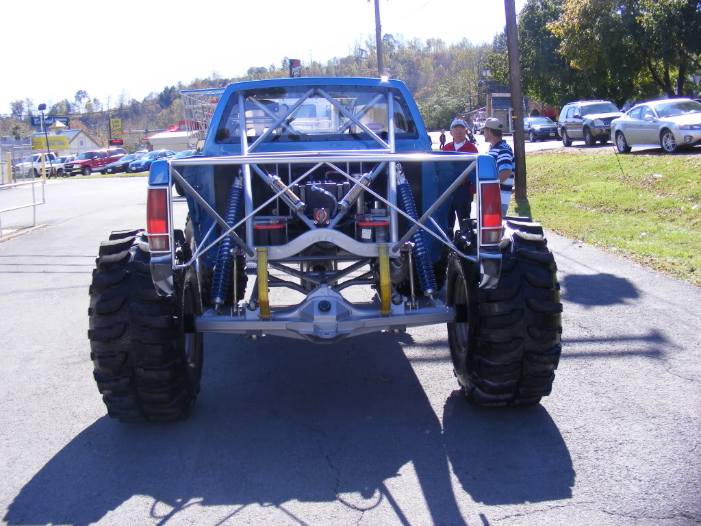

i know most of you probably have tail rigs and rock crawlers but they have got to be some mud trucks out there. ill post pic of mine soon
My buddes that I work on every now ad then.

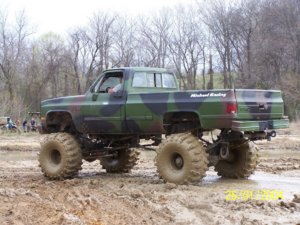

ours
our trucks

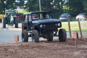

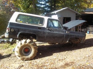

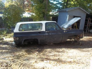

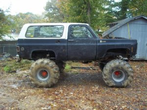

Josh's truck is pretty nasty. im the one with the old black K5 on rockwells and tractor tires at the lexington pit. well had the old black K5 got a 91 K5 coming out soon

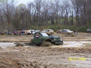

my old one
this was my first 2.5ton truck. weak stock 350 and granny low 4 speed 205 case rockwells and 18.4x16.1s. there some pic of it in the new mudlife mag at the lexington muddy play grounds and also on 4x4cross.com

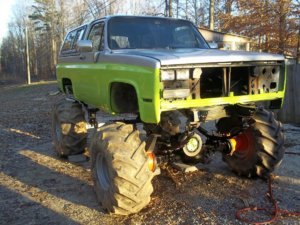

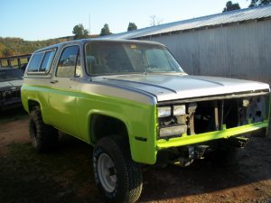

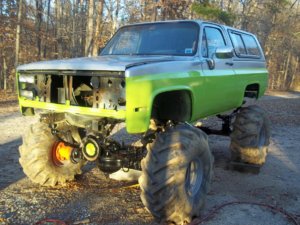

New one in the works

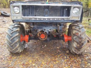

I got sick of the rusted out body no power no flex and wanted something that i could be proud of so i got me a clean 91 K5 roller and it went from there with a eye grabbing color.

as of right now its the same springs that was under the other blazer but im really thinking of doing coils in the front before i bring it out. looking to go with dodge 2500 4" coils springs and triangulated 4 link in the front and stay with leafs and traction bars in the rear. its going to have new built big block that is done just waitting to be dropped in auto trans with stall and a drop box to get the gearing where in needs to be

it has 2 1/2 rockwell rearends welded front and rear flipped hubs. BBC with 600+hp 850 double pumper and a 400 turbo with all 1410 shafts i'm running 54" boggers on it now witch i don't think are as good as the 49" iroks it's gettin tractor tires for next year it also has warn bumpers front and rear.
