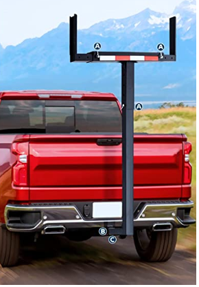

The rear is easy, I can just pick up one of these.
But how to support the front is stumping me.

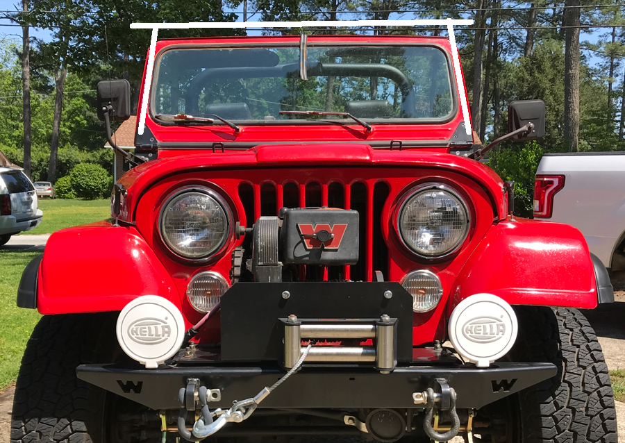

I was originally thinking I could mount one of those bolt on 2" receivers to my front bumper and use another one of those carriers up front, but I'm worried it would end up being too long for my canoe.
I had another great idea to use an old school light bar that mounts to the windshield, but finding a second hand one is difficult and a new one is till $250+ (which seems crazy to me).

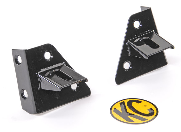

Now I'm thinking maybe I will pick up a set of those windshield light brackets and bend a piece of tube to mimic a light bar and just make my own... problem being the only thing I can bend at home is conduit. Canoe weighs 80lbs.

I’m still thinking the old school style light bar idea is the best.
Just need to either be patient (which I don’t want to be) and find a used one, or figure out how to make one…
For the weight of a canoe I’d go the route with the light mounts. Make a bar out of thin wall 1.75” HREW literally outlining the windshield frame and weld a couple small eyelets at the outer corners to secure a strap too. Let the canoe rest on top of the soft top and strap the tail of the boat down to the trailer hitch and send it on down the road. You’re not hauling elephants for crying out loud.
Agreed. Leave enough space to put you a pad on the bar as well.

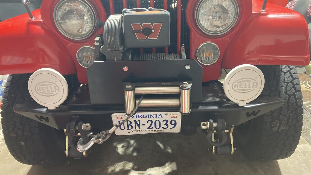

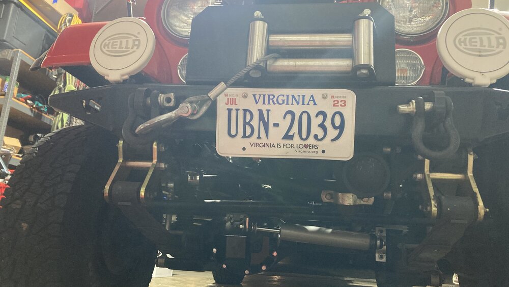

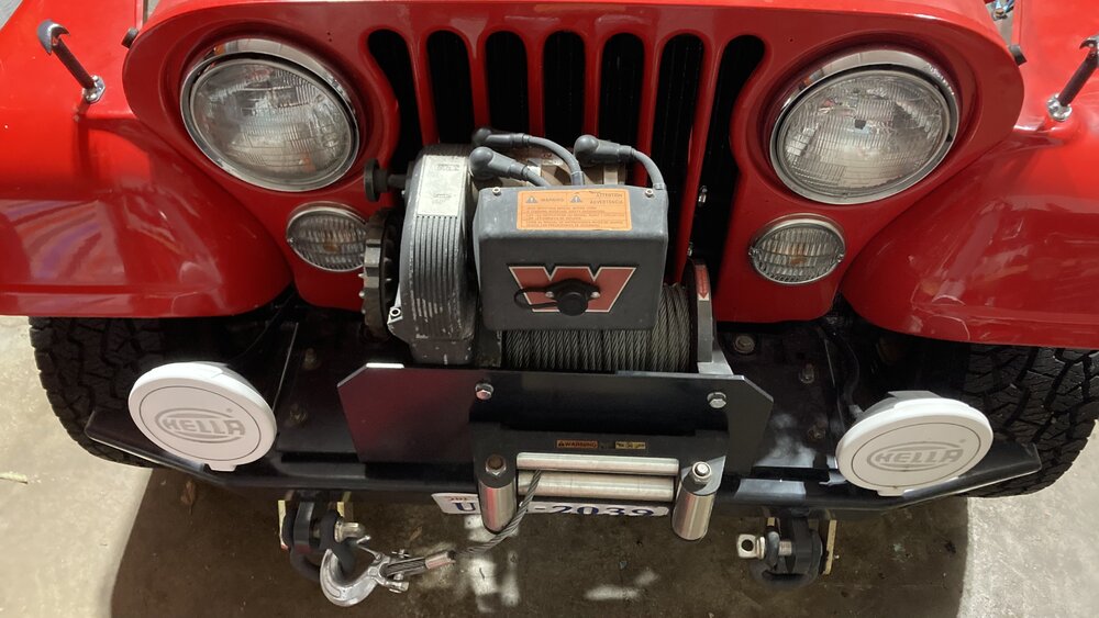

What is the current front bumper arrangement?
Be cool if you could fix something to attach to the d-ring tabs

Rear insert. Two uprights in the front with cross bar. Connect front to rear. Done. Make rear beefy enough to carry the front to back loading. O use those four bolts holding the flat of the winch tray to make a bracket fitting or a front light weight receiver.

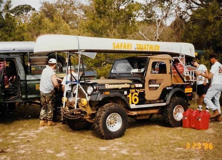

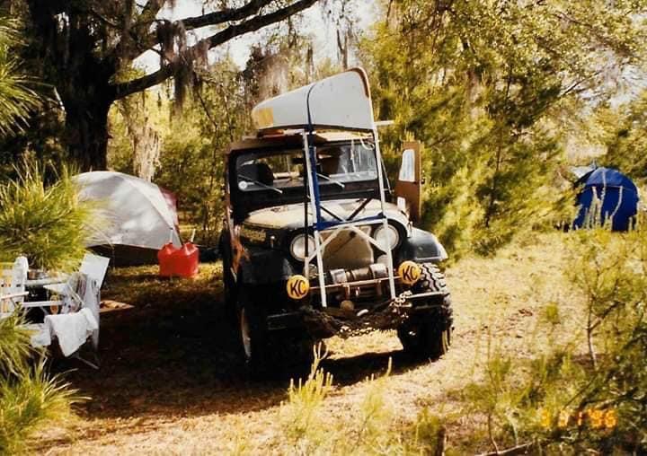

I think Mike Hundley from the Trailblazers had a canoe rack mounted to his front bumper of his CJ years ago when he and Robbie Mozely did the safari triathlon in FL. This was back in the late 90’s. Maybe dig up some old photos and see how he did it.
