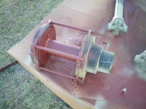

See the pic below of my winch during cleanup. I'm sure its the same one you have. I will try to find the part number of the one I ordered.
It looks very similar. I am going to get the PN off of the winch tomorrow and call them up to see if they have any ideas. I can live with $200, but $600 was pushing the limit of me just buying a new winch. Let me know.
All I can say is to call them. I didn't look for the receipt last night, but I can tonight to make sure I get you a part number.
