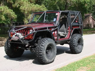

Sorta like to this one
Yes I know that is a JK, Its hard to find a TJ with one, Which makes me want to do it more.

Why not go internal cage with some bars on the outside protecting the fenders and such. You don't see many tj exo's because there isn't much need when you're topless and they're heavy. The one pictured is a bit much IMO
