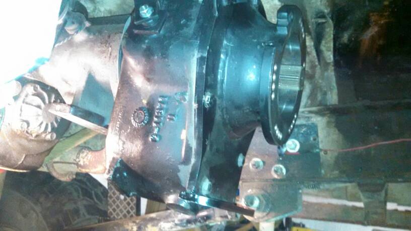

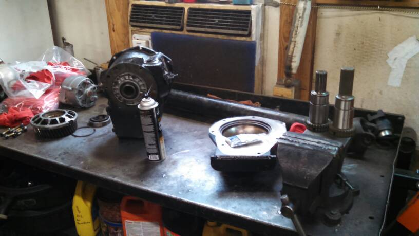

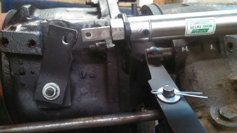

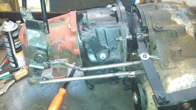

I just put one in my f150 that's in my profile pic. It works great. Good workmanship. I bought mine used from a friend who bought it off pirate but never installed. The kit I have was actually a 203-dana300 kit but the bolt pattern matched up I just had to change the 203 output shaft and notch the mounting flange for the 205 shifter rail. The 203-205 kits would already be set up right but I got mine cheap so it was worth it. I had no trouble getting a hold of the guy at Jed's about the new output shaft.
In these pics you can see the difference between the dana300 23 spline and the Ford 31 spline shafts. You can also see my home made notch. The 203-205 kits will be factory notched and have better clocking options. My 205 is homemade twin sticked and I'm air shifting the doubler.
