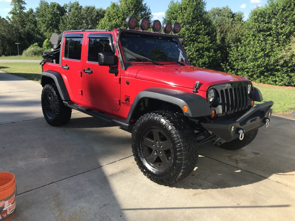

I'm looking at buying a 2009 Jeep Wrangler Unlimited Rubicon (4dr). It has 145k miles on it. Lifted, wheels and tires all that good stuff. I'm looking for hands on experience from those who have owned a JK Wrangler with the 3.8L before I buy. It's a very nice looking Jeep and appears to have been well taken care of. Thanks for the help!
See if it has been re-geared, tuned, etc. And DRIVE IT ON THE HIGHWAY. My 2011 would not run above 65 with 35’s before I tuned it. Looking at either re-gearing it or selling it completely to purchase another truck currently.
The 3.8 is not a bad motor, some have complained of oil consumption issues, mainly due to running 5w20 as suggested. 5w30 usually resolves this issue.
Being a Rubicon it allready has 4.10 gears, which are adequate for 33,s. 5.13 is needed for 35,s or it will be a dog on the road.
If the price is right and well taken care off I wouldn't write it off.
