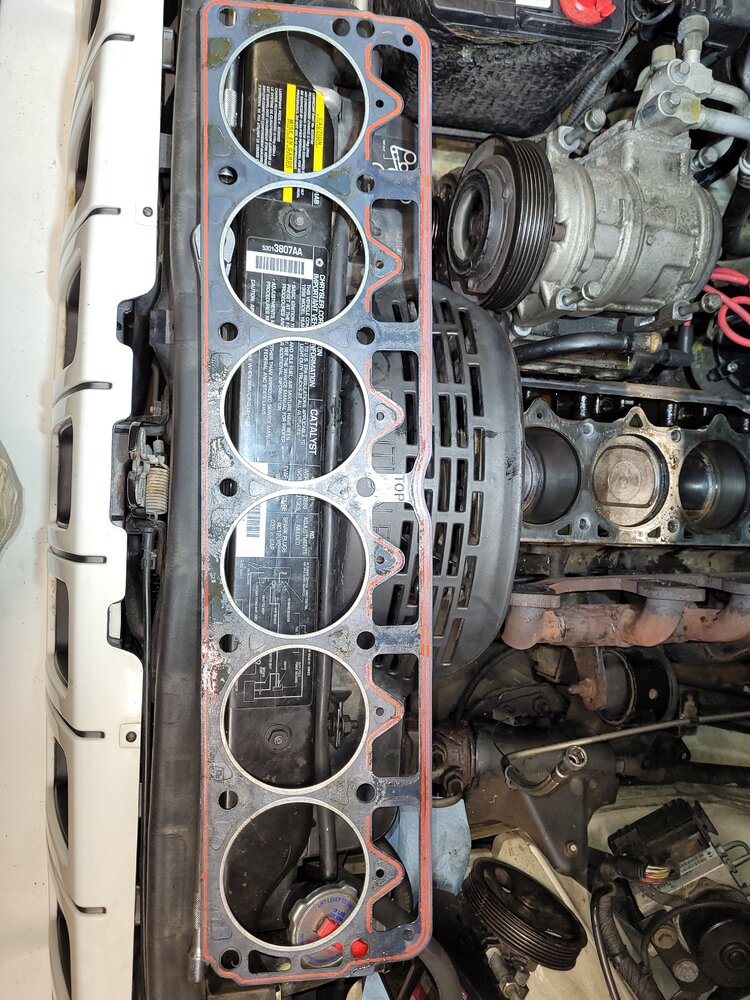

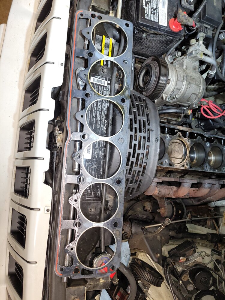

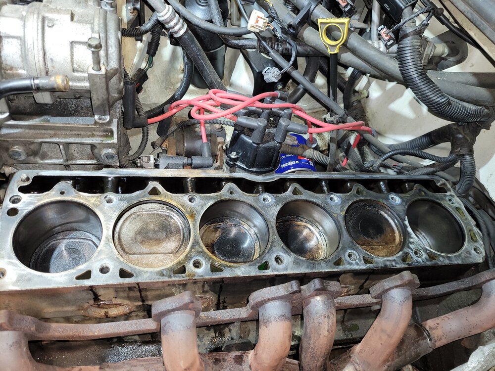

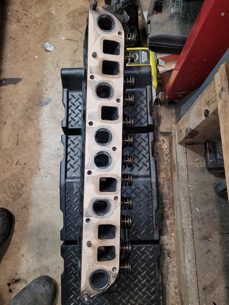

I pulled it apart and snapped some pics, incase there is anymore feedback.
To update...

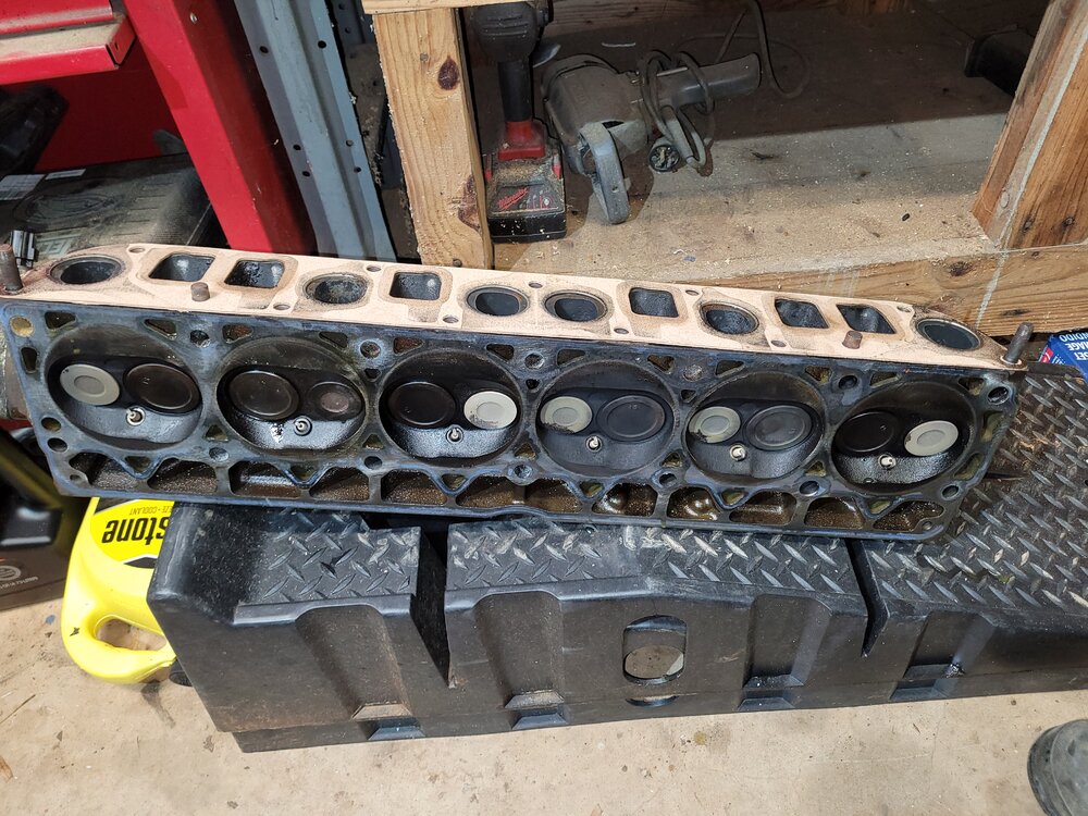

Pulled the head, and the valves out to take a look. All of the valves and seats had carbon build up and alot of pitting. Decided to get the head rebuilt. While it was off I also cleaned the injectors. Put it all back together and it still has the same rough idle/miss.

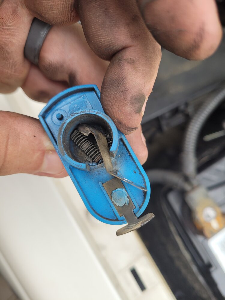

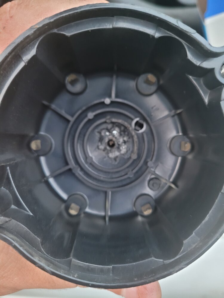

A friend had a "good" IAC that i swapped in, with no change. Pulled the dizzy cap to check the shaft play, and cap and rotor were toast. Not sure how it was running at all.
Changing those and rechecking the plugs didnt fix anything.

Wow, that is the worst cap and rotor I've ever seen!
I couldnt believe it was even running at all. The crazy part is that new parts didnt make it run significantly better.
