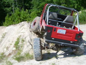

Cool man, hey do you have a pic from the rear so I can how you cut the fender around the corner?
sure, here is one of where I cut it at and how it looked with the comp corner put on. I cut it that way mainly b/c of the shape of the BTF corner. Other corners have a less rounded transition to the rear. if you're not using a corner on the rear you can of course cut if however you'd like.

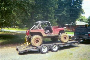

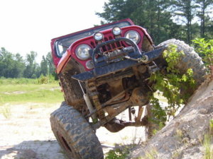

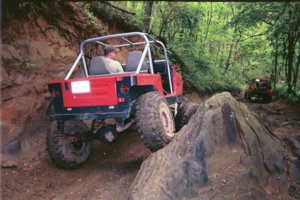

Here are a few more comp cut pictures. I didn't make it pretty because I feared it would turn into the ugly theme I have with the jeep anyways. :bling:
I had cut out the fenders to fit bushwackers a couple years back, that's why the front of the fender is cut all the way to the inner well. Future plans after the motor swap are full wrap rear tube fenders, tied into the frame, cage, sliders, and front tube fenders. That'll make the rear cage mount tougher because after cutting all that metal away, there doesn't seem like much support for that mount.
Runnin 38's, Scout II dana 44's. Pushed the axle back 6 inches (which ended up lifting the rear an inch or two...but I blame that on the beer).
I need longer shackles but am afaid of having them stick to far past the bumber, thinking I'd back into a tree and reverse the shackle easily.
