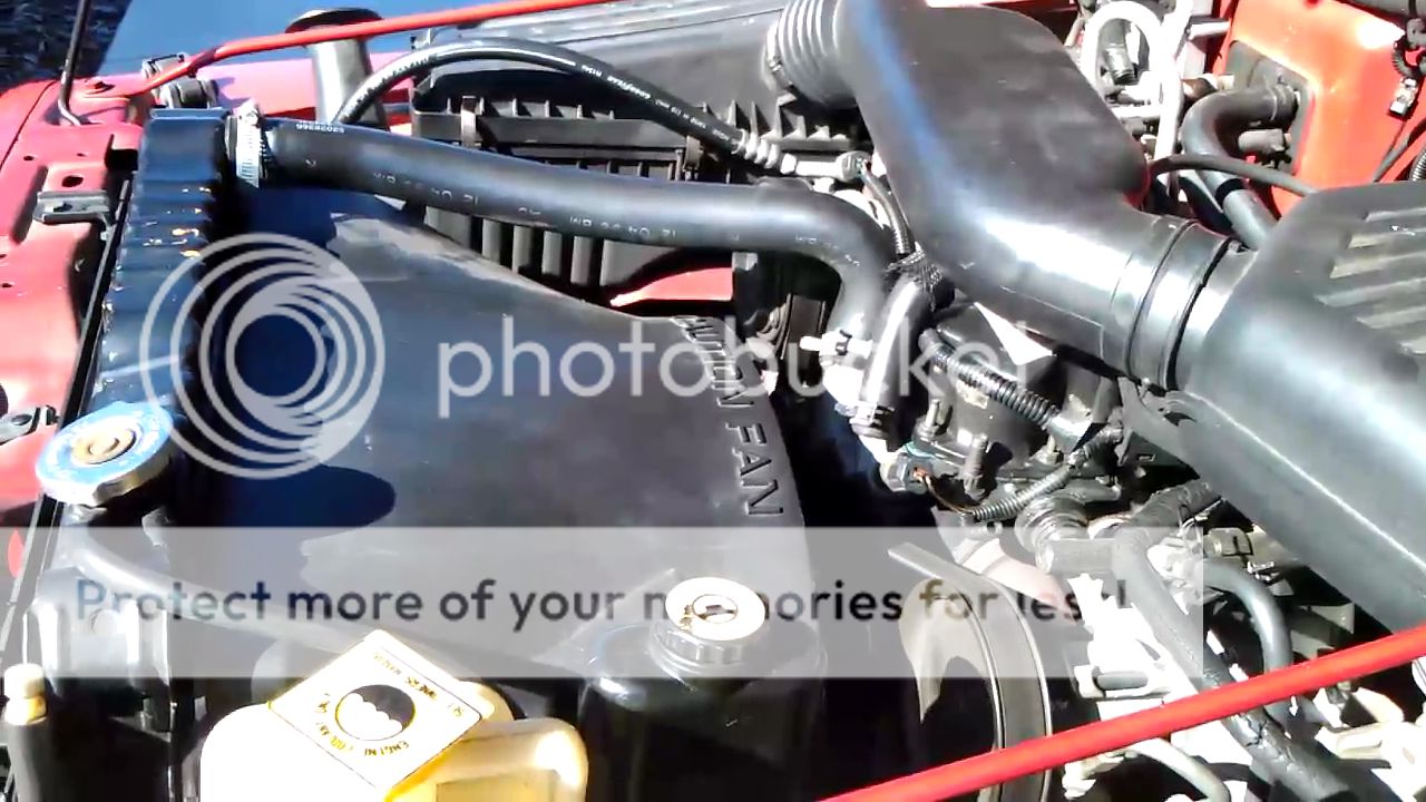

I just inquired a new 99 TJ, that has a strange knock in the motor. Just wondering if anyone knows a good jeep mechanic around the Hickory area.

I usually work on my on stuff but this has me stumped. I took it to one mechanic already and he said timing chain and it wasn't. I was just hoping there was a mechanic near me that knew a lot about these motors. I'm just going to pull the oil pan down tomorrow and see if I can see anything in there.

2.5 liters have a plastic tensioner, that can bust into pieces and cause the timing chain to clack against the cover. But I should give y'all a little back ground on the jeep. My mom bought it brand new about 3 years ago the oil pump broke and she had the engine rebuilt. She got it back and and it had this noise in the motor, they worked on it on and off for about a year and could not figure it out. She gave up on it and just drove it. In January she bought a new car and sold the jeep to me, it now has 30k on the engine and no metel in the oil. It sounds like a diesel at idle and when you rev it up it gets less pronounced but doesn't fully go away

It has the factory oil pressure gauge and oil pressure is fine. 30-60 psi
