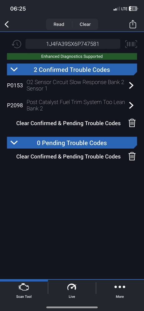

Keep getting code P0153 on jeep 06 Jeep TJ 4.0. Replaced all 02 sensors with NTK 170k on jeep so I replaced them all. At operating temp bank 2 cat reads about 300 degrees hotter than the other. So I’m just going to replace the mid pipe and was looking for some suggestions Walker,Flowmaster, Mangnaflow brands? Any suggestions would be appreciated.

Haven't went that route yet to check. Code comes and goes. Jeep runs great in the morning on beach trips. But we just came back last weekend and didn’t leave Hatteras till lunch. Check engine light came on after about driving for a HR. I usually get 250-260 miles off a tank. I was only getting 125 miles off a tank. Got home ran the code and it was P0153 bank 2 sensor 1. It’s done this multiple times coming home on trips in the heat of the day.

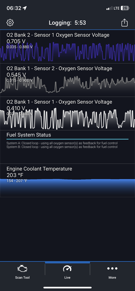

Graph showing at idle

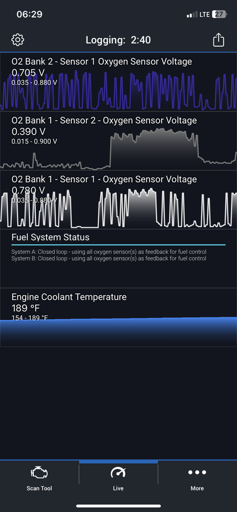

Graph while driving
The voltage on the downstream sensor fluctuating like it is doing shows the converter isn't efficient. A properly functioning cat will be evident by a steady downstream sensor signal.
When the DS sensor mimics the upstream one, it shows the cat isn't doing it's job.
