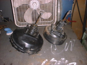

Im running 1tons w/ stock 3-3/8 calipers and 3/4ton calipers out back.. Was running the stock YJ booster w/ '78 Grand Marques Master.. I can stop the jeep pretty well but have to use a lot of the pedal travel to stop when in 4low (automatic/4:1 tcase). I have always lacked enough fluid volume to the rears that they will continue to spin in 2wd on wet ground.. anyway......
My new tow pig has the 8600# package which gives it the JB7 brake package (GMs nomenclature for different size brake systems, 1/2ton=JB5, 3/4ton7200#=JB6, 8600#=JB7, JB8 etc..) Some parts swap between levels some require the next bigger part but they all seem to swap...
So while i had the master off I said hmmmmm... i wonder if that will fit on the heep.. SO i took it off the tow pig and to mu good fortune it was very similer in many ways to the stock YJ unit... stock YJ unit is ~8.5" diameter, the JB7 unit is 11" This will give me the ability to easily handle the large bore masters cylinders. So I bought a reman unit for the tow pig Note: the booster is same as the JB6 reg. 3/4 tons and I could have got one at the junk yard, but that takes time and cost $$ SO i bent over for a remanufactured unit on the tow pig.

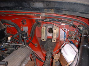

The 4 bolt mounting flange was slightly larger and used larger bolts, but was very similar to the YJ unit and only required me to enlarge the stock jeep mounting bracket holes to 1/2". The push rod was exactly the same length. The bolt spacing for the master cylinder was wider but since I was installing a matching newer style master cylinder I didn't care about that. (just wanted to mention it) Also the master mount is NOT recessed like on the YJ unit.. That could make it easier to adapt to other masters.
I needed to tweek the brake pedal as the pedal stud was 1/2" and the new master requires a 9/16"-ish stud. I thin bushing could also work.

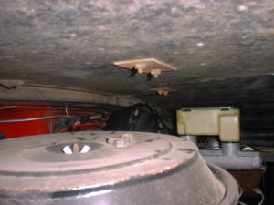

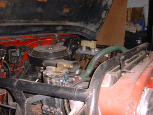

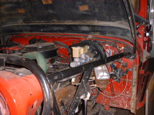

Fitment - It just fits :) It clears the hinge mounting rib on the hood but ~3/4" and clears the top of the hood also by 3/4"
Even if it doesn't work, it looks good !!

The new larger bore master (1-1/4")definitely was the trick for me. The larger booster definitely doesn't hurt either.
