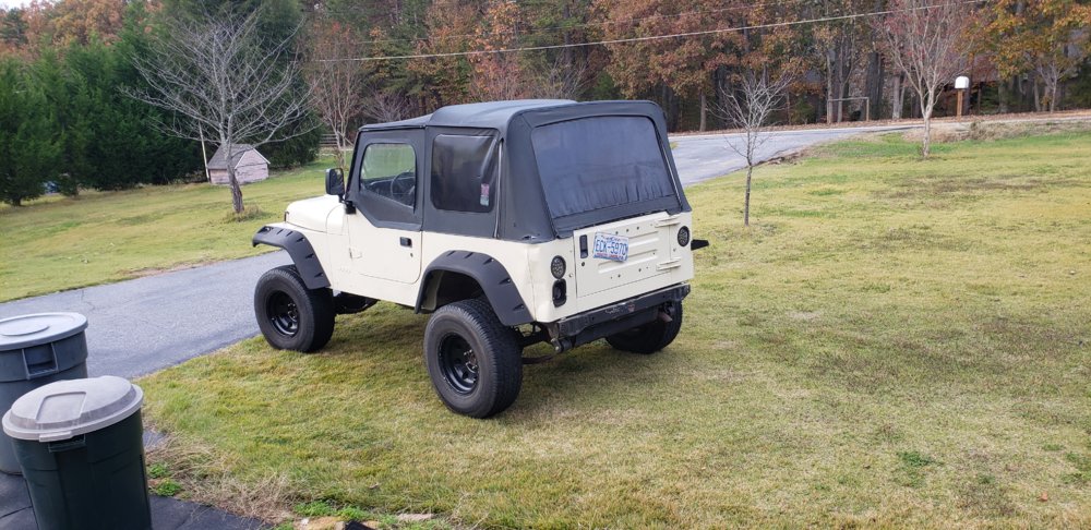

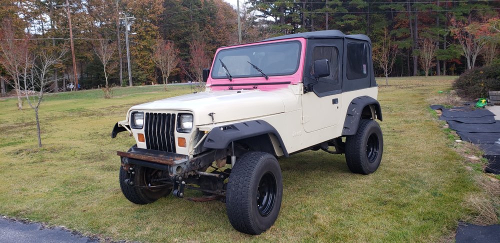

So I was originally on this forum with my K20 step side truck a few years ago. Our son was born, and truck sold. Somewhere in that pile of life, we picked up a wrecked 95 Yj. As bad of an idea as it was to buy it in the first place, we have done some work to it. Let me start with general specs.
1995
2.5L
5spd
4.5" RC lift
Tom woods rear driveshaft
slip yolk eliminator
31-10.50-15s (aluminum wheels)
The trans was replaced by a previous owner, and the jeep was painted Pink. Barbie doll pink. We Towed it home from Marion (incase anyone knows who previously owned it), one of the front spring hangers was ripped off and one of the leaf springs crunched. (Hince the lift and such) We opt'd for the military wrapped springs, and since then I have been fixing little things here and there. I just got a radio in it and the speakers working for the first time in 3 years. LOL. All in all, it does well for my back and forth commute.
Ultimately, I'm starting to struggle with the performance now. I have looked up mods and such and have basically convinced myself not to spend any money on the performance of the engine. I am however looking in the direction of gearing. With no plans to start cutting on this thing any time soon, and coming from a higher performance back ground, I'm looking for pointers/ideas on how to keep my self busy for now, because if I keep digging, I'm going to end up buying full width axles, trying to stretch the frame, and fit 40" tires on a daily knowing that I also don't have a garage/building to do such work!
So what I am looking for here is basically a discussion of the limits of having a daily driving offroad rig, and planning some kind of map to budget building a jeep Yj. (yes selling a 2.5 and buying a 4.0 may be better, but given our current situation is not really an option) I'm basically trying to be an irresponsible-responsible adult.
Yes, a bumper, etc may be some of the things everyone thinks, but humor me please.

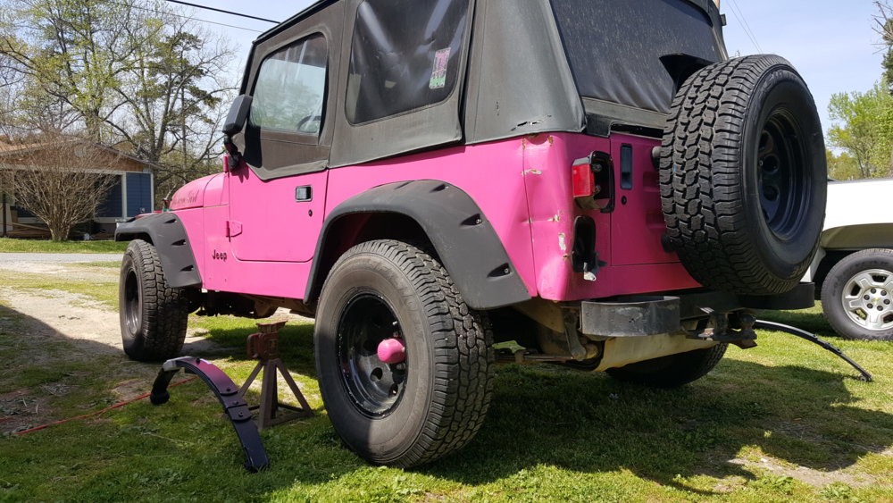

How it sat when we got it.

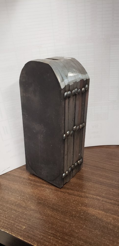

So I brought the factory shackles to work, may try to make a sturdier version so I can replace the boom shackles and lower it back down a little bit. 31x1050's are more in my budget then 33x1250, and seem to be easier to come by. I also like the idea of a low center of gravity, so reducing the lift and cramming bigger tires later would be fun... Anyone got any thoughts on that? I haven't changed the pitman arm yet, so it will likely remain stock if I do this. Also plan to remove the fenders. I had put them back on to try to sale the jeep and was going to let anyone that bought it decide what they wanted to do with them, but now I think ill just remove them.
My attempt to make shackles during a 1 hour break. Gotta cut the other side, grind the radius, then i'll likely chuck them in the mill to square everything up.
So I got the ends cut and ground, the holes dilled, and obviously in doing that, the shackles separated. If this shackle is going to be stock height, is there any point in adding a cross connector to each pair? I've seen where lift shackles have a through bolt, or a welded piece in the middle, and adding that isn't a problem, but seems like there's potential for limiting the suspension if there is an unnecessary cross piece? Otherwise, i'll be priming these tonight or tomorrow...

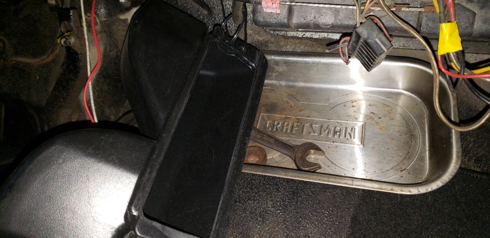

Soooo just something random about heat with a 95 yj. If you're already missing the diffuser at the bottom of the dash like I was, save your money and use a magnetic tool tray.. works better then the diffuser if placed in the right location on the trans tunnel.. 20181203_170747.jpg
