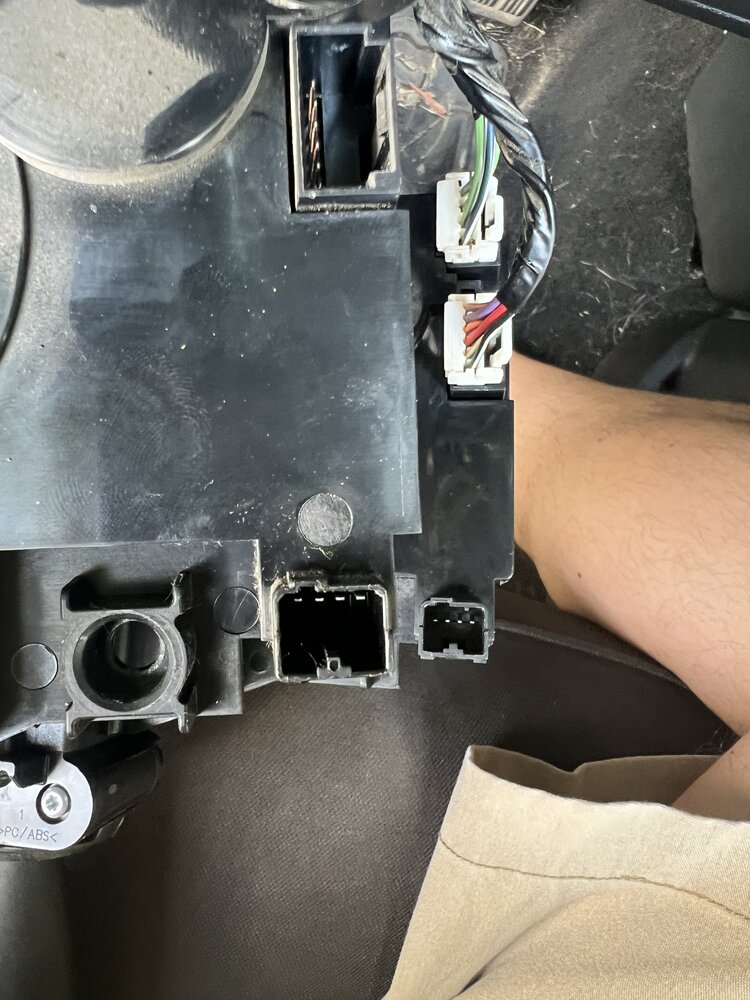

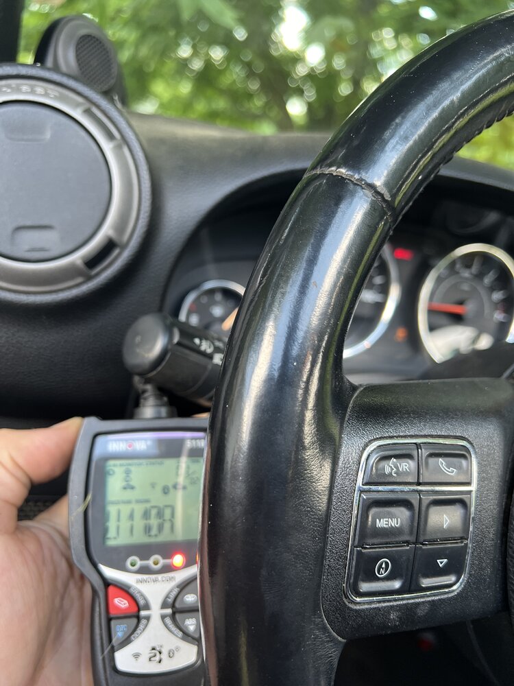

MattRRT Member Joined Apr 22, 2021 Location Albemarle Tuesday at 2:30 PM #1 Replaced the clock spring with a non Mopar unit. Fired it up and traction light on. Still no cruise. Engine light now on. Wasn’t before. Getting code U110A that won’t erase. A Cam bus code I think? Do I put the old spring back in? Attachments IMG_2584.jpeg 137.8 KB · Views: 12
MattRRT Member Joined Apr 22, 2021 Location Albemarle Tuesday at 4:42 PM #2 Had a bent pin on the black connector. All good now!! Attachments IMG_2590.jpeg 146.7 KB · Views: 12
