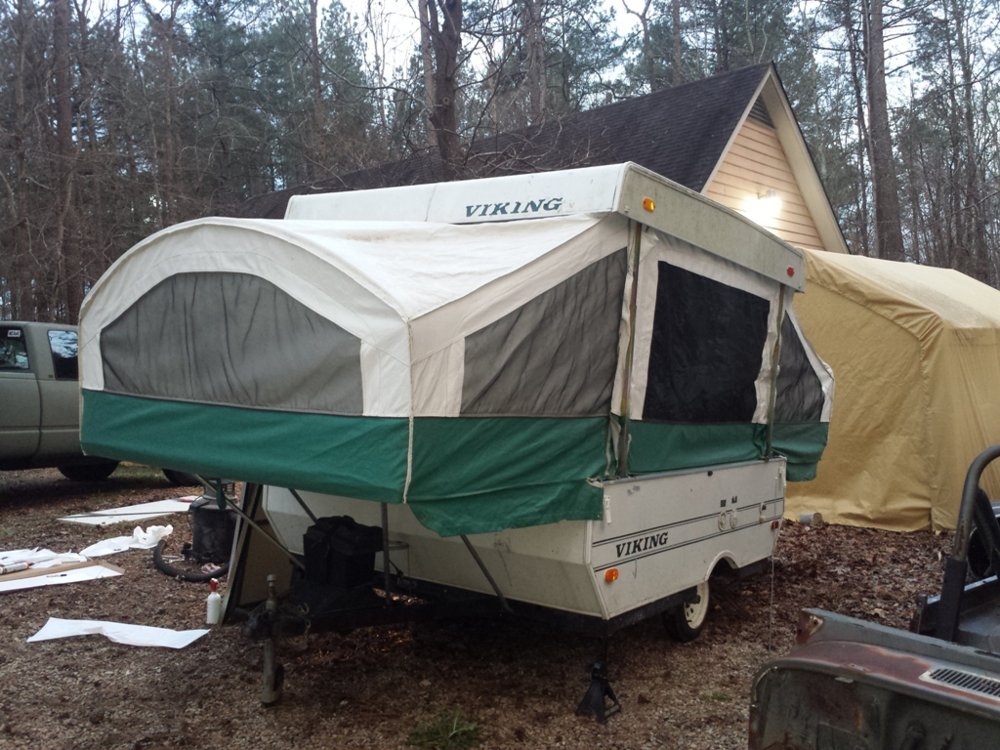

We've been talking about doing this for a while now, finally did it. Was trying to sell an S10 here at the shop and a guy offered me this in trade.
It is a 2000 Viking popup. The flooring was a little rotted and he replaced it but never laid any linoleum back down. We're going to do some kind of newer flooring, clean it up and haul the kiddos out to the camp ground!
Pretty excited about this. Eventually we'll be able to pull it down to Uwharrie with the XJ and spend the weekend.
Pic is only partially set up, I'm working today and just had it out to check things before trading.

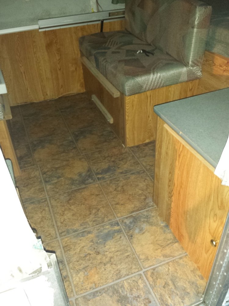

This thing is almost ready for camping! I laid down a bit of caulk on the floor in the seams where the previous owner repaired the floor. Overall pretty solid repair, just needed touchup. My son Chase and I ran to the store and got some new flooring, he picked it out. Got vinyl plank flooring, the ones that float, not peel and stick. Pretty happy with them, need to go get one more box to finish up one side, but almost done!

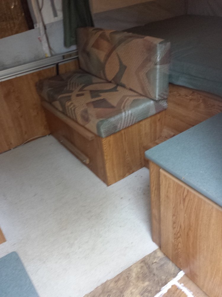

Before - like a bad kitchen
After - like a bad kitchen with decent flooring

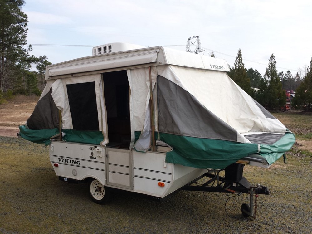

All set up and ready for camping!
It looks like your cables in the back are not lifting the camper top fully. There are many sites that have adjustment procedures
Bought mine from a member on here that put grommets every foot or so in the bottom vinyl tails that hang down below the 2 beds. I take "S" hooks in them and thread them with a rope and it seals off the bottom much better with no chance of falling out at night. I HIGHLY recommend that mod!

Thanks @Willc I'll look in to that. I didn't notice it was off until you said something. I didn't actually have it cranked all the way up, it was about an inch or so from full lift.
@6BangBronk that's a great idea for the grommets and S-hooks. I'll definitely do that.
OK, I think I found the problem. The rear pulley for the Goshen system is attached to a metal rail across the back of the camper. That metal rail is bent in slightly, probably because the system was not maintained and the grease is probably dry. My thought at least. I am going to grease the shit out of the system and weld a reinforcing bar on and reattach the pulley to see if that corrects it.
