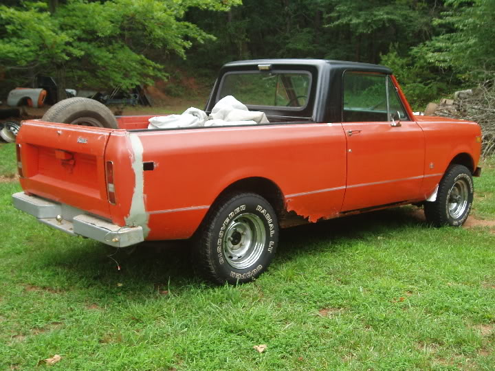

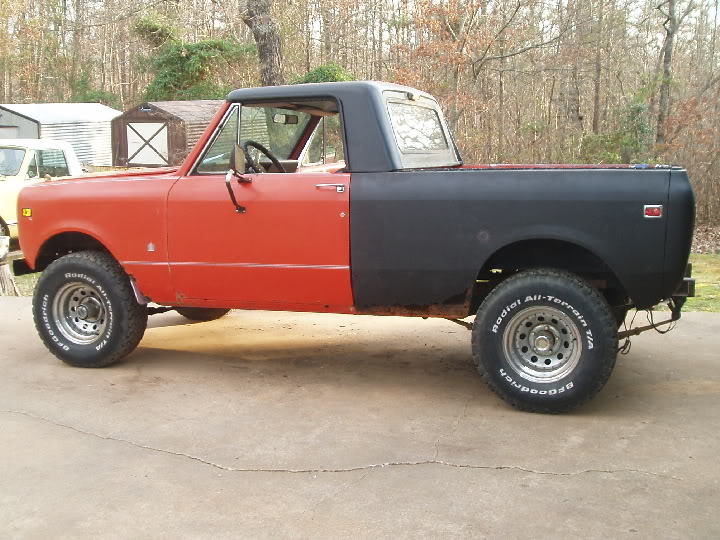

Thought I'd throw up some pics of my Terra that I've been DD since Jan. I just finished bobbing the rear 12 inches and will SOA it in the not so distant future. This one's gonna take over trail rig status eventually. Plans are SOA, rockers, cage, propane, & lockers. Probably swap out the close ratio T-19 for a wide, and pop in a twin stick D20 that I just came across in a parts Scout. Plans will continually change, as with all "projects". Here's a link to more pics and words - http://www.binderbulletin.org/forums/showthread.php?t=65619&page=1&pp=30. Hope you like - :flipoff2: .
This is how I got it last year:
And this is it so far - have to make a bumper next.

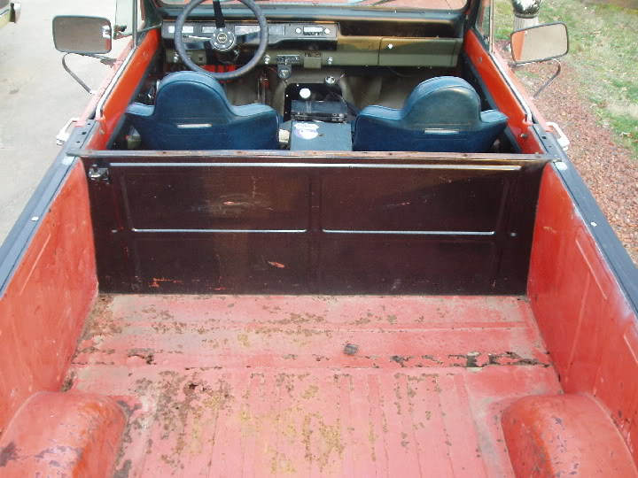

Any chance you have pics of the bulkhead? A friend is looking at a '73 that appears to have bulkhead from a 1/2 cab, but now has what looks to be a CJ windshield/hinges attached (some bastardized "windjammer"?) and I'd like to know what the OEM panel looks like.
I like the bob!
Here's a pic - let me know if you need more. They bolt in from the inside.

Are you going to cut out the rust on the bottom of the quarters?
Yea, I've got to order some patch panels from a company in OH. Once I get my rockers figured out, I'll weld them in. After all the body panels are back together, I'll shoot the whole truck back to original color. Got a buddy in Wilmington who is gonna help in that area.
I'm happy with the way it turned out. I like how it looks as though I will be sitting mid-rig now. Almost equal approach and departure angles too. I'm psyched:driver: !! Thanks for the comments.
