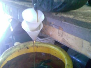

This is my gravity actuated (thanks Terry!), two stage, de-oiler, complete with catch can...

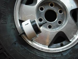

The next day I can get in the shop to work I will be making a jig to do the same thing Matt did. I'm going about it a different way tho because I don't have a way to turn down an axle shaft. I'll post up pics when I get it built. I'm making a jig to use a holesaw on the wheels.
#1 Custom tool to oversize the holes in my GM wheels to fit on toy axles. 2 hole saws with a 1/4" bolt in place of the drill bit. (grind flats on ends for set screw) Used cheep elec. tape to center it up just right. After drilled, i hit it with some emery cloth paper taped to the hole saw...

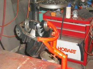

#1 Toy diff chunk holder, grabbed the holes that are the same on 4cyl/v6/e-locker...

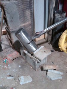

I have a few regulars that come in my shop who watch and CRITIQUE me because they know EVERYTHING. And I can't tell you how much I like using a hammer on something on a customers vehicle and these folks telling me I need a bigger hammer. It really gets under my skin. You don't use a bigger hammer on a customers truck. If you need a bigger hammer then your doing something wrong.
So....... This thread came along and inspired me to make this for when they say I need a BIGGER FREAKIN HAMMER. I plan to use this on their toes. :fuck-you:

Mars, can I use your BFH as my avatar??
man....that is one bad ass hammer though
Mars is now the KOH's :fuck-you:
