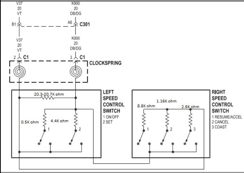

I just installed cruise on my 05 LJ and need to troubleshoot the steering wheel switch. Parts were used off Ebay so may be a bad switch. Anybody in the triad with an 05ish with cruise that would be willing to let try their switch. I will drive to you or meet. The cruise light does come on with ignition with engine light etc... but once the vehicle is started it will not come on when I press the on/off button.
I got it figured out by testing the switch and as the symptoms show only the OFF circuit at 20.6K ohms is working. All other circuits are dead.
