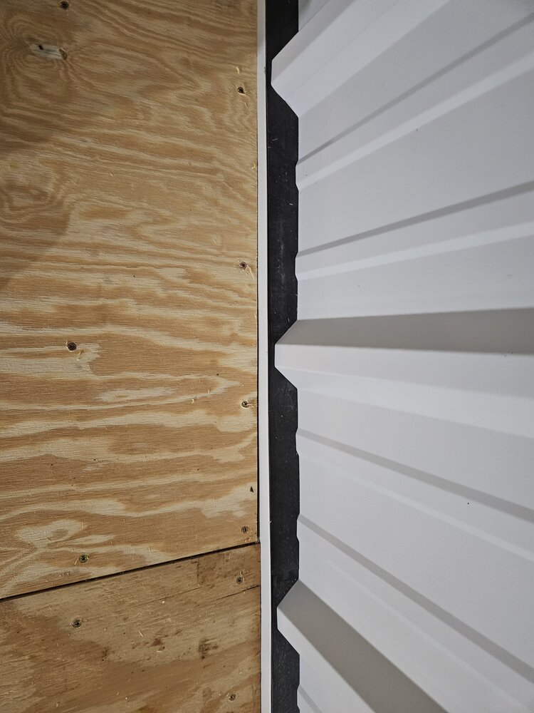

I've got the below situation, adding a mezzanine or loft to my shop. As you can see in photo tin goes floor to ceiling and plywood is just gonna run into it like the demo below. Only two ideas I've thought of is cut chunk out of the tin and add a piece of j-trim and the flooring will just run under it or notching the plywood to the contour of the tin. Either option would require 80ft linear foot worth of modification. Yall have any better ideas?

i would setup a sliding jig and use a router to contour the wood.
trace out the pattern on a 3 or 4 feet long on a piece of wood and cut it out carefully to fit with a band saw or jigsaw then clamp it to a target then use a router with a guide bearing and cut the contour of the pattern then move the template and repeat.
The company that made and sold the building will have foam inserts to fit the ribs of the panels.
You put in an "L" flashing from floor to wall then stuff (might need construction adhesive) the foam insert between the vertical part of the flashing and the panels.

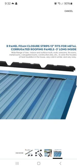

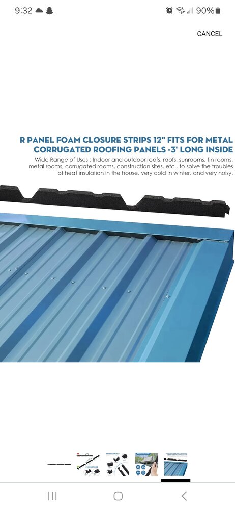

I believe you are talking about foam closure strips. I actually had someone mention those just forgot to put that in original post
