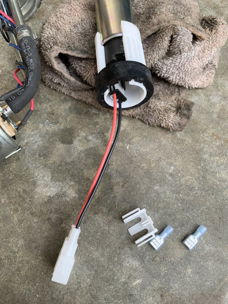

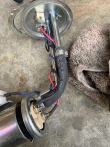

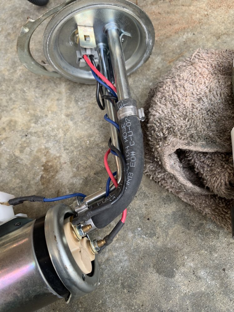

I’m finally getting around to changing out this fuel pump, my question is, can I cut the red and black wire from the current pump and splice some female ends on the wires to plug into the new pump plug?

Yes you can just make sure your crimps are good. It's a bitch to go back in if one vibrates loose. I've installed many pumps where they came with a new connection and supplied regular but connector to use in the tank. It'll be fine, no boom.
cool thanks! Going boom is what I was worried about, even though the current set up had the ring terminals and all, was still suspicious.
Even on an empty tank with the cap on there's not really enough oxygen present to make a boom, spark or not generally. I won't say it'd never happen, but there are more Chevy pickups running around Fayetteville with blue butt connectors in the gas tank than I can count on my fingers or toes, LOL.
Just make sure it's a good crimp. You can't use tape obviously, and most heat shrinks won't stand up to being submerged either.
Yeah that’s what I was reading, about the oxygen part. My dad was saying maybe use some sort of gas resistant sealant around the connectors ? I’ve got a tube of gas resistant sealer and gasket maker I was gonna dab a little around the connectors once crimped. Just for extra precaution?
Gas resistant and able to be submerged all the time are 2 different things, I'd leave well enough alone
Fuel is non conductive and non corrosive. No sealants or anything are necessary. Keep the positive wire from electrically touching anything and you're good to go.
