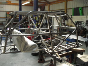

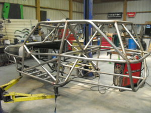

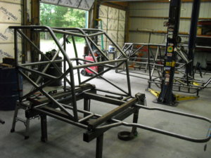

This will be a Tj front Clipped 4 seater Turn key build with and Ls engine,auto,atlas,tons,42's.
that is going to be alsome

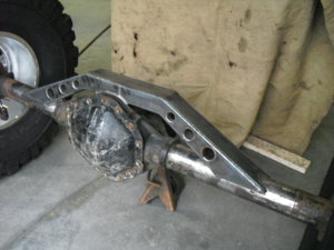

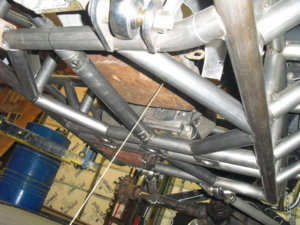

truss
pics
pics

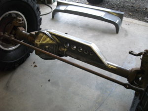

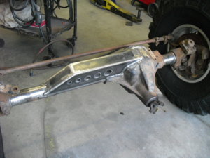

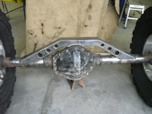

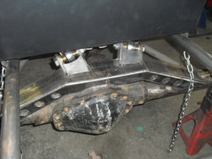

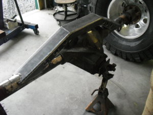

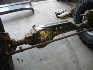

14 bolt truss

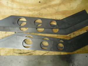

Got the truss done.. These will be up for sale this week for the DIY or welded ones.
Looking good PJ. Do you have any plans on the 14 bolt truss where it will tie into a pinion yoke guard?? (not trying to hi-jack)
yoke gaurd
Benjie,
Probably not. There are a lot of companies that offer a pinion guard that just bolts up to the axle. A lot of makers put the two together becouse they only have a single 3/8" plate going across to weld to the axle tube. With this design you are getting over 60"(inner and outer of the boxing) of weld on the tube and another 10" on the cast housing. thanks for the interest.

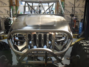

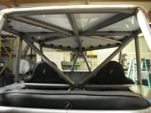

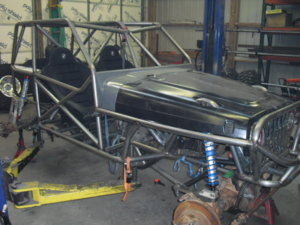

updates

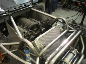

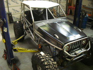

Got a few updates.. Thanks scott for the logo cutouts.. Just what i was wanting.

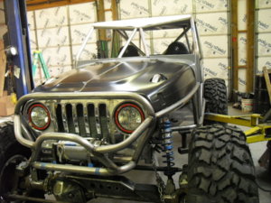

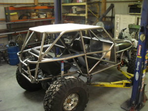

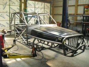

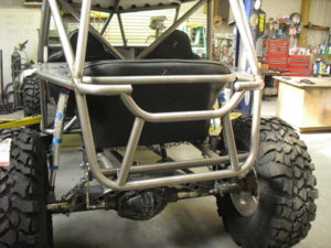

pics
more

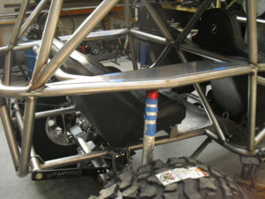

I think this is your best looking buggy yet! That front clip looks killer with the grill hoop / trail stinger tied together. Looks like you could drop that thing from a 20 story building and it wouldn't hurt it. :beer:
thanks
thanks, Coming from a fellow spark maker i appreciate it..

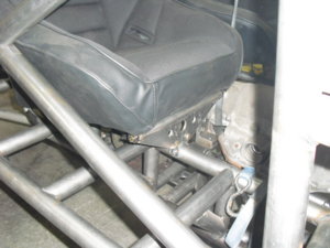

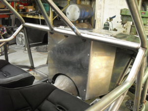

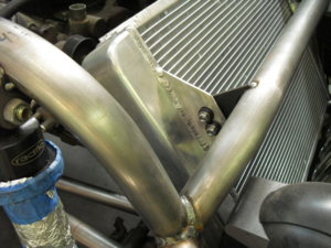

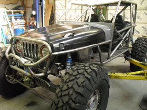

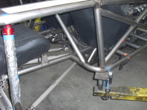

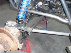

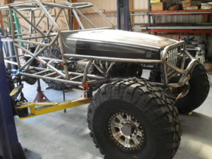

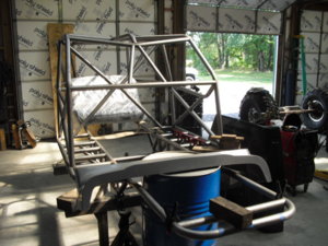

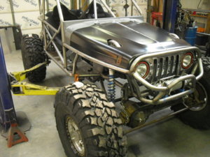

pics

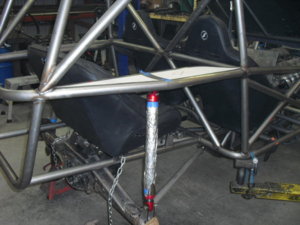

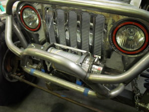

more

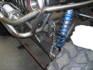

more
Damn...you made a Jeep look good.
Wasn't sure that was possible.
:beer:
