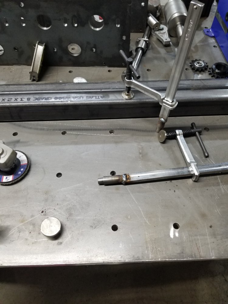

So it was 6" centers, but anyway I buy those HF welding clamps when they're on sale, turn some .75" stock down so it's a slip fit in the table holes and weld it to the clamps.. Kinda like woodworking table clamps. Screw threaded hole tables.

So it was 6" centers, but anyway I buy those HF welding clamps when they're on sale, turn some .75" stock down so it's a slip fit in the table holes and weld it to the clamps.. Kinda like woodworking table clamps. Screw threaded hole tables. View attachment 298104
Why not just turn down the end of the clamp instead of welding a stob on?
