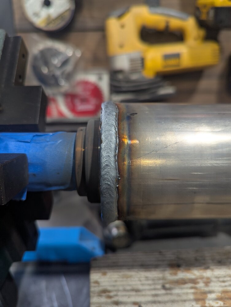

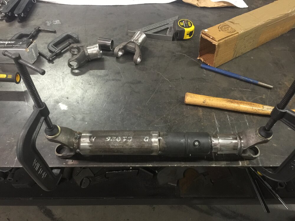

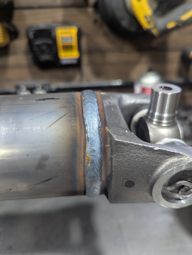

My method of welding: one good tack, rotate and check with the dial indicator. Whack it at 180* to equal the first tack the tack it. Rotate and repeat until you have 4 tacks at 90*.
Burn her in. Never had one move.
Exactly the methodology used 👍
