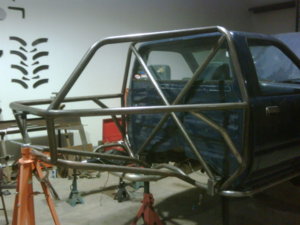

This is a truck I'm building for a customer, I thought he might like to see some pic's of it on here. When its finished it'll be a full tube back half and pretty minimal front exo and bumper. 4-link rear, 18" air shocks,
Here's the start of the sliders

It's an all toyota build with yota axles. That's the reason for the really simple exo, I don't want the body to look too wide for the axles.
I really hate that you built that bed like that, because I didn't get around to it first!! Ive been floating around with almost that exact shape for my comanche. I figured I would go with 14" airshocks, though.
I plan on ordering them this week, but I was wondering if you think the longer 18" shocks will balance well with a leaf sprung front end? Seems kinda extreme?

Yea man there are so many different designs out there its almost impossible to not copy someone else. There aren't but so many ways to do it.
I have a buddy that runs this similar setup on his yota, 18" air shocks rear and 6" all pro springs up front. It flexes better than most buggies I've seen. In the near future I'll more than likely be building a link suspension for the front of this thing too. So I figure we should go all out on the rear now and not have to upgrade it later.
